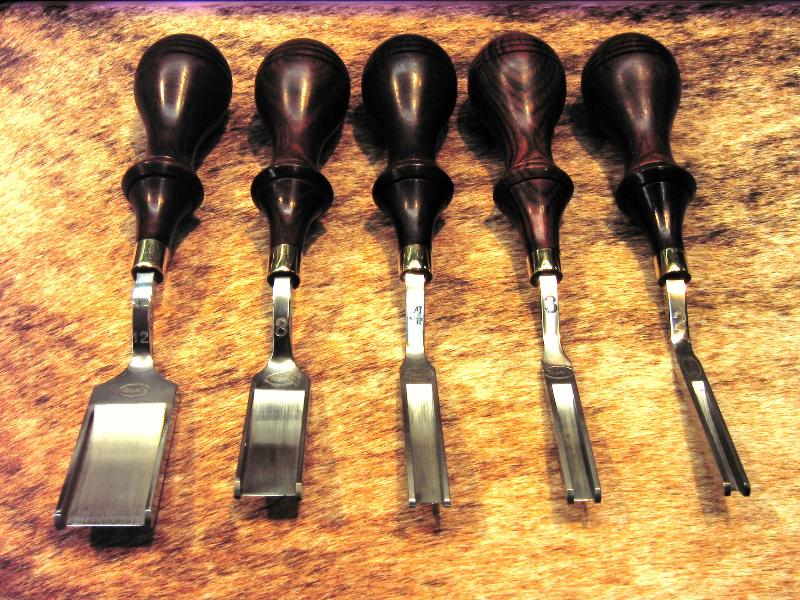

	If anyone is interested I have decided to sell my Ron's round bottom edgers and French edgers. I am only doing so because I have finally accumulated enough antique Gomph tools that I can't justify having two separate sets. These tools are in excellent used condition and are at least as sharp or sharper than they were when I bought them new. They are all stainless with beautiful Rosewood(?) handles. There are five French edgers for $350 and four round bottom edgers for $275 and that includes the sharpening guides. At this point I am not interested in breaking up either set. If anyone is interested in either of these sets please email me soon. I thought I would list them here before putting them on ebay or taking them to the Wickenburg show. Shipping for either set (or both combined) should be around $5 or $6 using Priority Mail. My email address is hidepounder at cox dot net.
