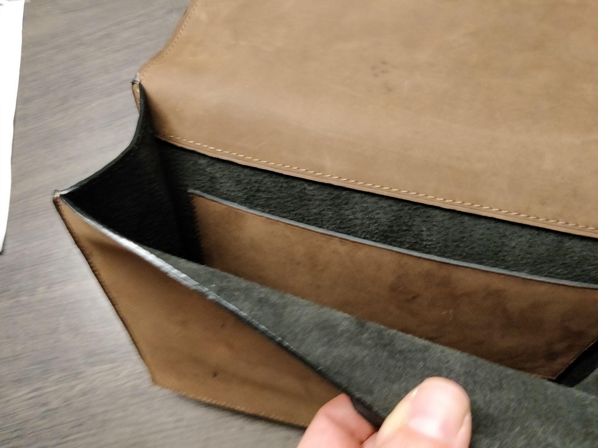

hello, your stitching is certainly acceptable. What I would do is bring more consistency to the whole thing. some examples Photo 2 if you rounded the corners on the inside I would also do this on the flap, like the brown pouch Photo 3 the same here the bottom of the rectangle are rounded, but the top is not, however here I would opt for a round patch. This way this stitching will also look nice around your magnet. The same for the inside of the magnet, a round patch would look quieter than the rectangle in my opinion Also the thinning of the leather where the bend is looks a bit rough, maybe you can try to even this out by going over it with some rough sandpaper. These are my remarks, about taste, shape and color you can keep arguing ;-) Practice makes perfect -

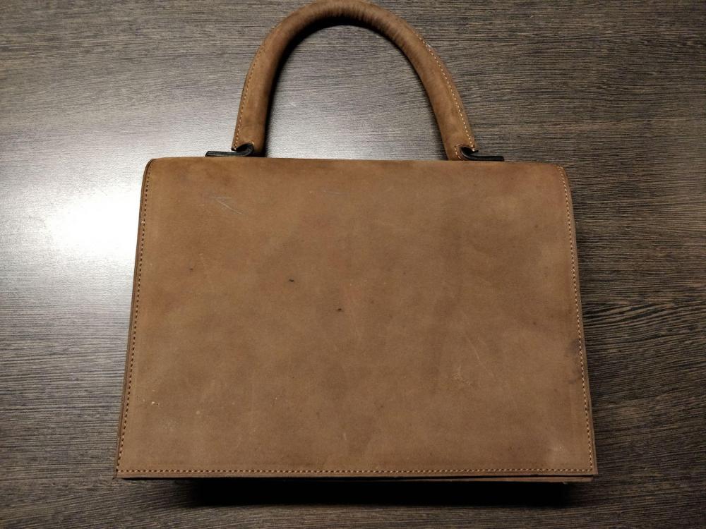

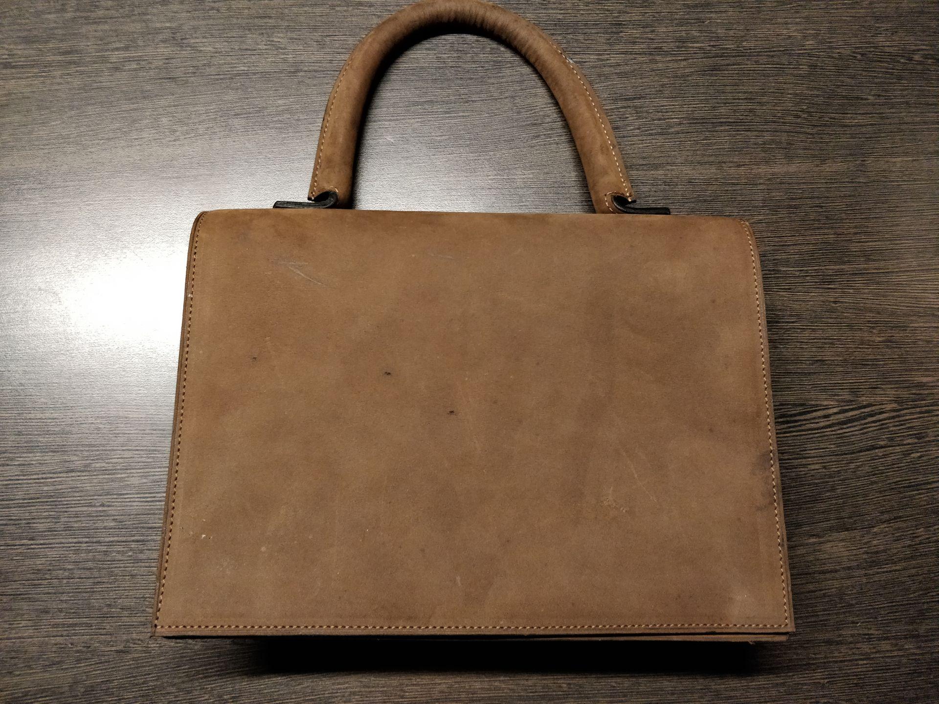

Thx for all the reply's and kind words. Some of the comments are justified, but I have to say we had to follow a particular pattern. The one handle does the trick, no issues here. The fastening is another case, first of all the belt is 1.5 cm (3/4 inch) to long to be effective. As you lift the bag it opens a bit by itself. I am going to shorten it a bit and see if the locks hold. I also think the magnetic lock isn't strong enough a push button would be better but hard to close. I did discuss this with the teacher 2 weeks ago. He told me he wasn't behind this design but a co-teacher of him wanted it in the course. I am not for or against it, I just want fool proof bag designs, and this isn't one of them. For me it just was a good exercise to practice some techniques but the end product is useless in the designed state. As mentioned before I rework the closing mechanism to a working state. I keep you all updated. The course is only 1 evening every week so everything goes slow maybe I rework it at home. Greetings B
