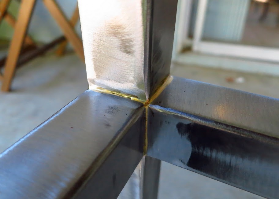

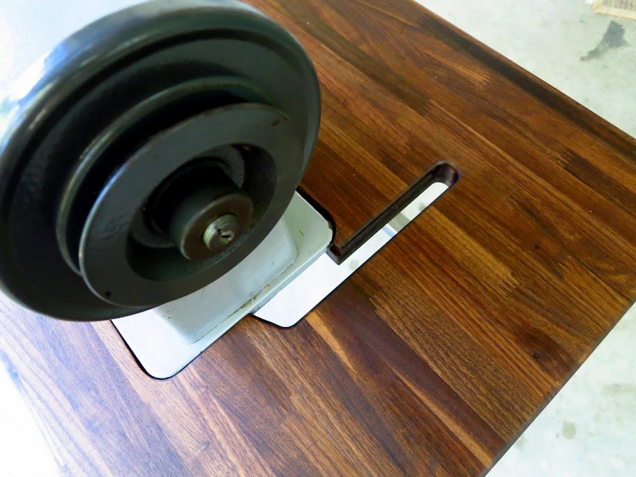

Members thesergeant Posted September 8, 2013 Author Members Report Posted September 8, 2013 (edited) Well, I enjoyed making the last table so much that I decided to make another one, but this time with nicer wood and more robust legs. I ended up brass brazing 1 1/4" square steel tubing for the legs and getting a 1.5" black walnut 20"x48" top and routed it out for my Adler 167. Super excited about this one. The walnut looks spectacular in person. I was hoping I could get a little input from you guys regarding the footpedal. I've been throwing some ideas around on how to install the foot pedal but I'm still undecided. I'd prefer a non-permanent solution. If you have any ideas please share. Thanks guys!! Edited September 8, 2013 by thesergeant Quote
Members shtoink Posted September 9, 2013 Members Report Posted September 9, 2013 Very impressive! I love the results. Quote
