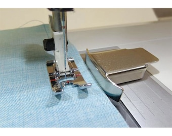

Contributing Member fredk Posted March 11, 2022 Contributing Member Report Posted March 11, 2022 For keeping the holes on your work piece equidistant from the edge whilst cutting or drilling or punching the holes you can use a magnetic thingy, like this one : I use one (a large one, top picture) on my sewing machines. It sticks to the metal bed and you just run one edge of your work piece along it so that your stitching, or holes in this case, are equidistant from the edge. These magnet thingies come in different shapes and sizes and cost just a few $$ (try the sewing section of Hobby Lobby, or on ebay or Amazon) PS. I'm working on an idea for a holder for my Tandy Press to hold regular type diamond awl blades Quote
