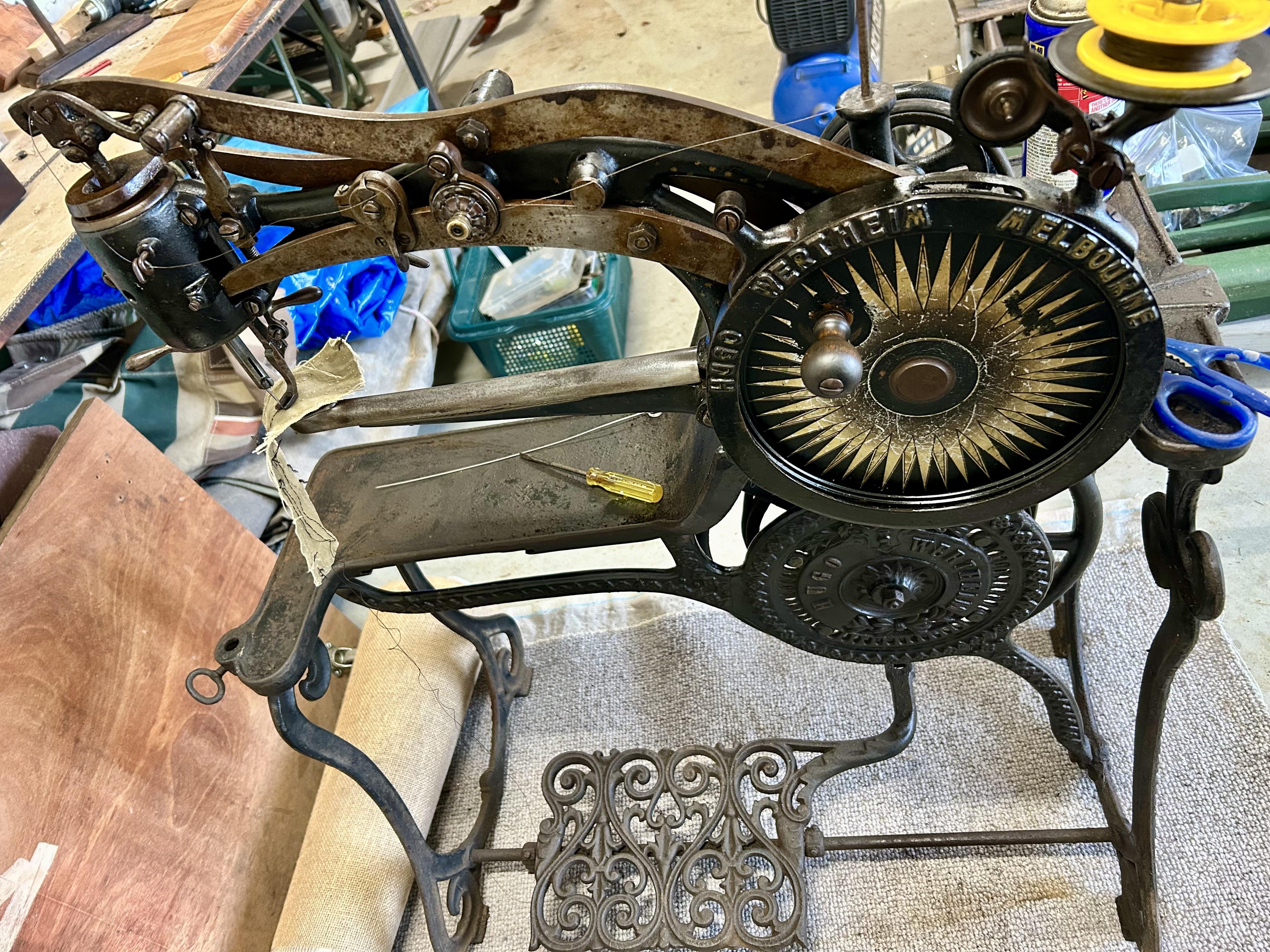

Needles should be system 88. Not sure which manual you have but this one (German Language) should be fairly close: Claes+Elastik+I+u+III_cleaned.pdf -

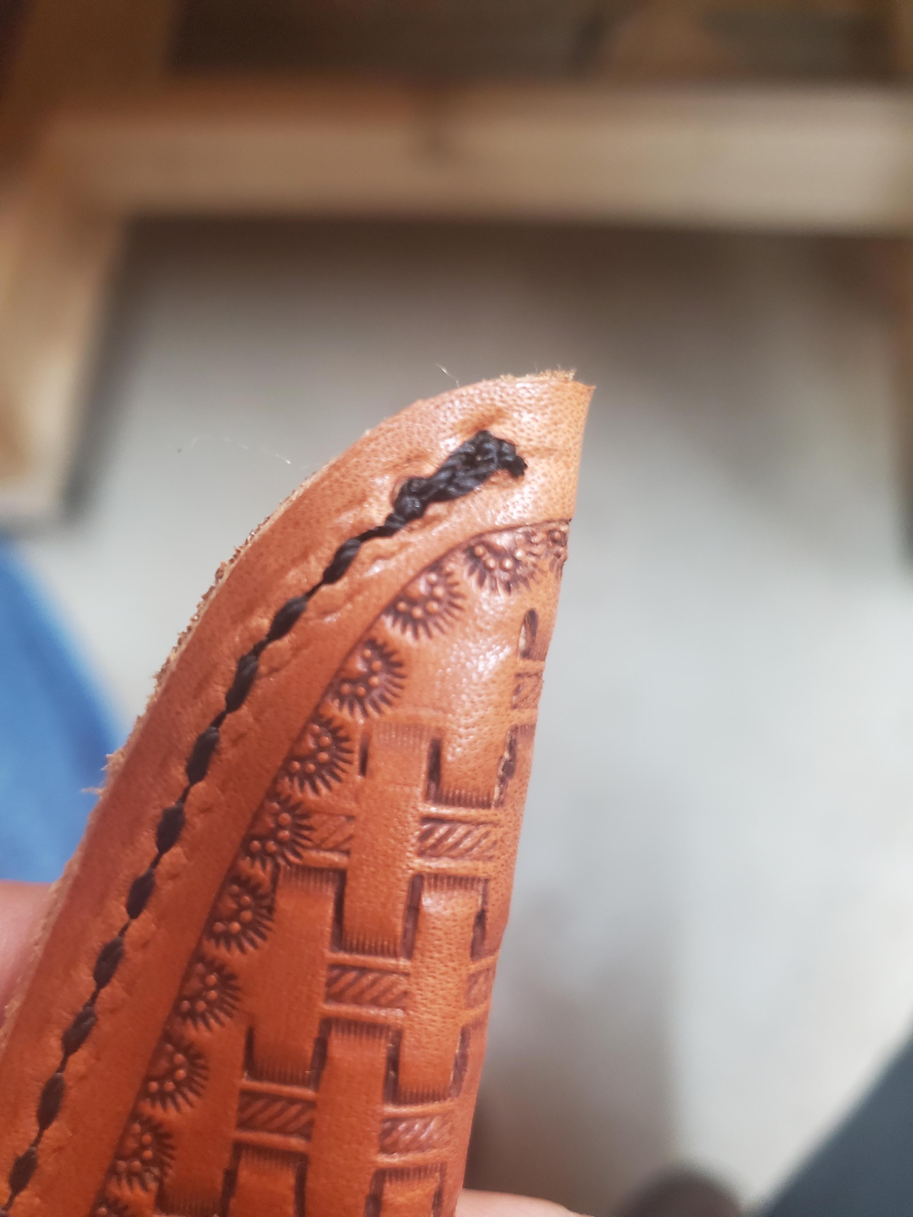

My bottom stitches aren't clean when I start. I make one forward stitch, back stitch, then go forward to finish. I have a Cobra 4. The pictures are of the bottom and top. Any thoughts? Thanks, Randy

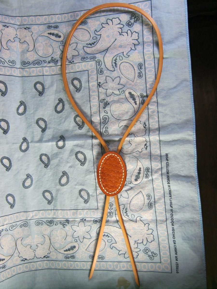

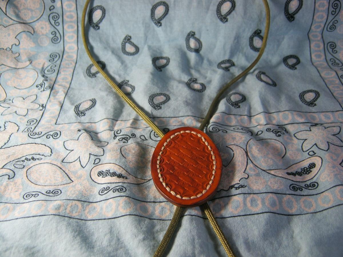

Take a piece of 8/9 oz leather . . . use a splitter . . . run off a square piece the same as the thickness of your leather . . . makes the bolo stand out much better than any piece of woven rope . . . Just an opinion from a guy who has several of them May God bless, Dwight
Decided that I needed a bolo , not having any hardware this seems to work right now . Holds fine being new and not used much but don't know if it will for any length of time .

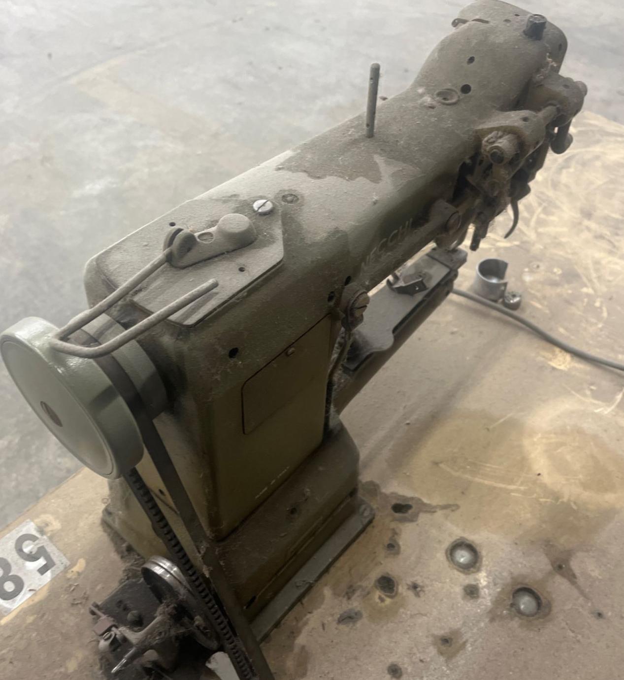

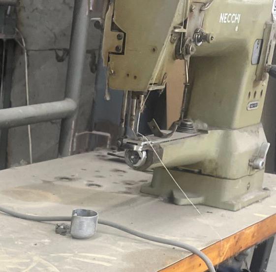

Hello! I finally found a reasonable sounding deal on a cylinder arm machine. When I went to pick it up the small parts that were pictured in the sale: Bobbin case, bobbin cover and presser foot, had all been lost. I had already paid for the machine and driven there so I took it home with me. I haven't found much info on the Necchi 840-100. Based on this thread on the very similar Pfaff 335, I ordered some cheap bobbins and cases online. They don't fit. The center hole for the bobbin case is slightly too snug to fit onto the center pin on the Necchi. The bobbin post on my rotary hook measures 4.4 outer diameter. These bobbin cases measure 4.3mm inner diameter. Could this be a matter of polishing the (cheapo) bobbin cases a bit further open so they fit? Anybody have advice, or know of a solid parts source for the Necchi 840?

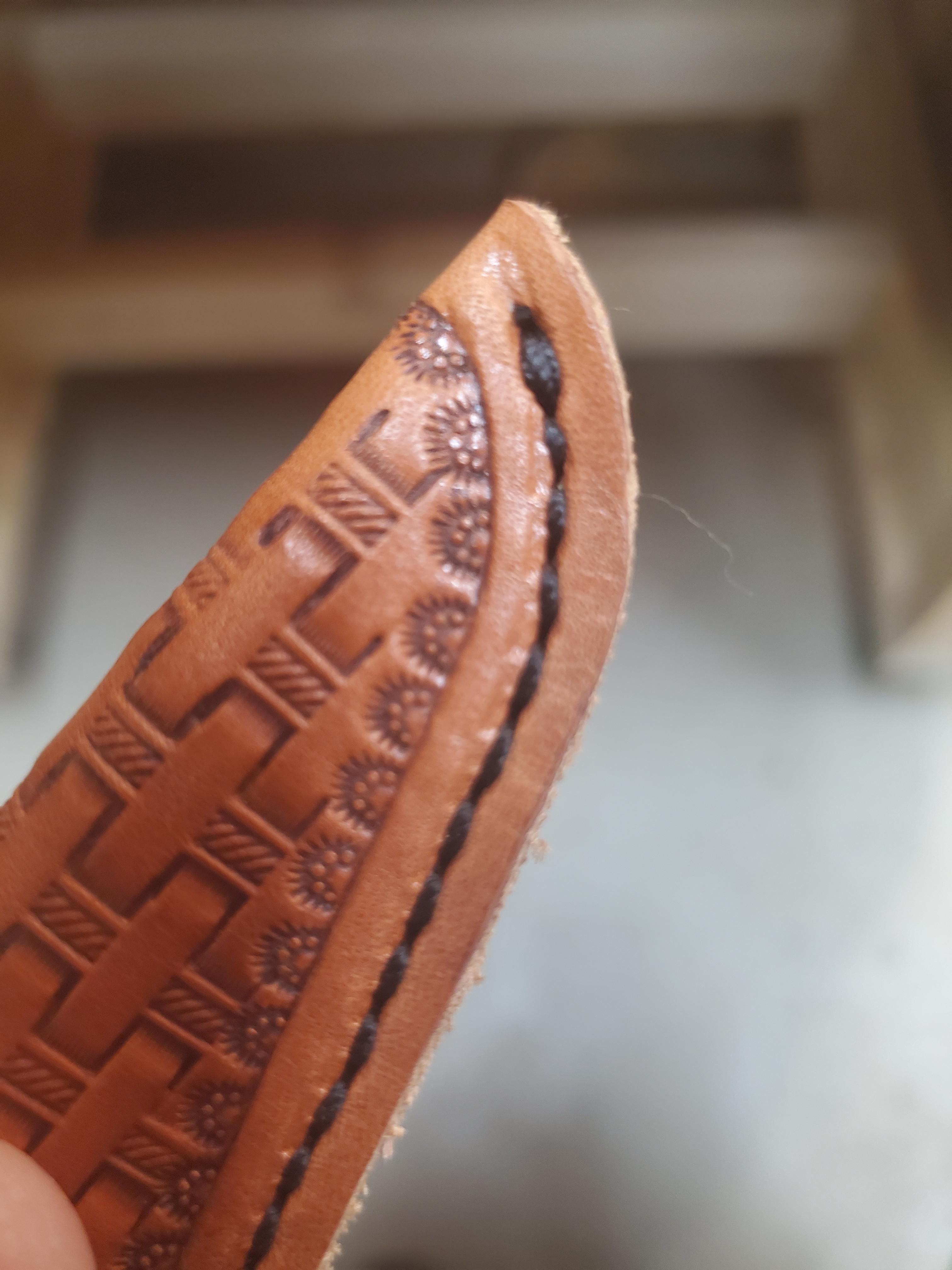

This morning, I brought in a colleague's belt for a repair. It is a Kore "Full Grain" Leather belt with a suede liner and is fitted with some type of a ratchet latch/buckle. It only needed restitched around the last few inches which I did straight away. I noticed that where the belt runs through the buckle, the edge had worn just enough you could see the layer edges so I hit it with dye, let that dry and then followed with Gum T for about three coats burninshing to my limited ability. I noticed the edges (belt is four or five years old) looked perfectly pristine almost like they are formed with epoxy or something yet not cracking or wear seen except where it passed through the buckle. My edging looked ok but would never compare to that factory edge. Is there some process where the maker molds those edges. They've sure held up well but are too difficult for me to duplicate. I'm not so much asking how to duplicated it as I am what in tarnation does the maker do to make that gloss slick (after all these years) edge hold up and look so good? TIA.

Hi all, I recently acquired an early Claes bootpatcher, badged “Hugo Wertheim Melbourne”. Its in great condition for such an old machine, filthy but no broken or missing parts, and I have managed to get it stitching with the help of an old manual in German, and the manual for the newer machines, in English. It came with some needles that are too short, I had to slide one needle down in the needle bar till it worked. I am interested if anyone has a manual for these old machines that’s in English. Also and more importantly, I would like to find a source for the proper needles, which I suspect is system 88, or even just the length of this type of needle.. If anyone can help I would be very grateful. Thanks in advance!!
