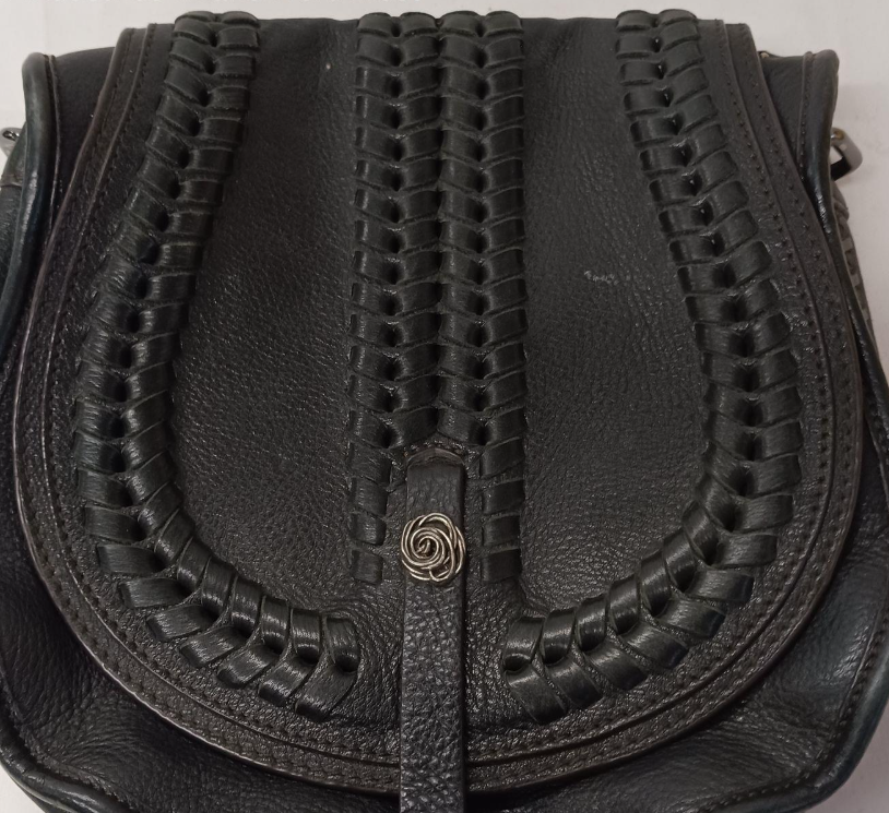

I found this pattern online and would like to learn how to do the pattern on the front flap. What type of weaving is it? I would appreciate any information.
