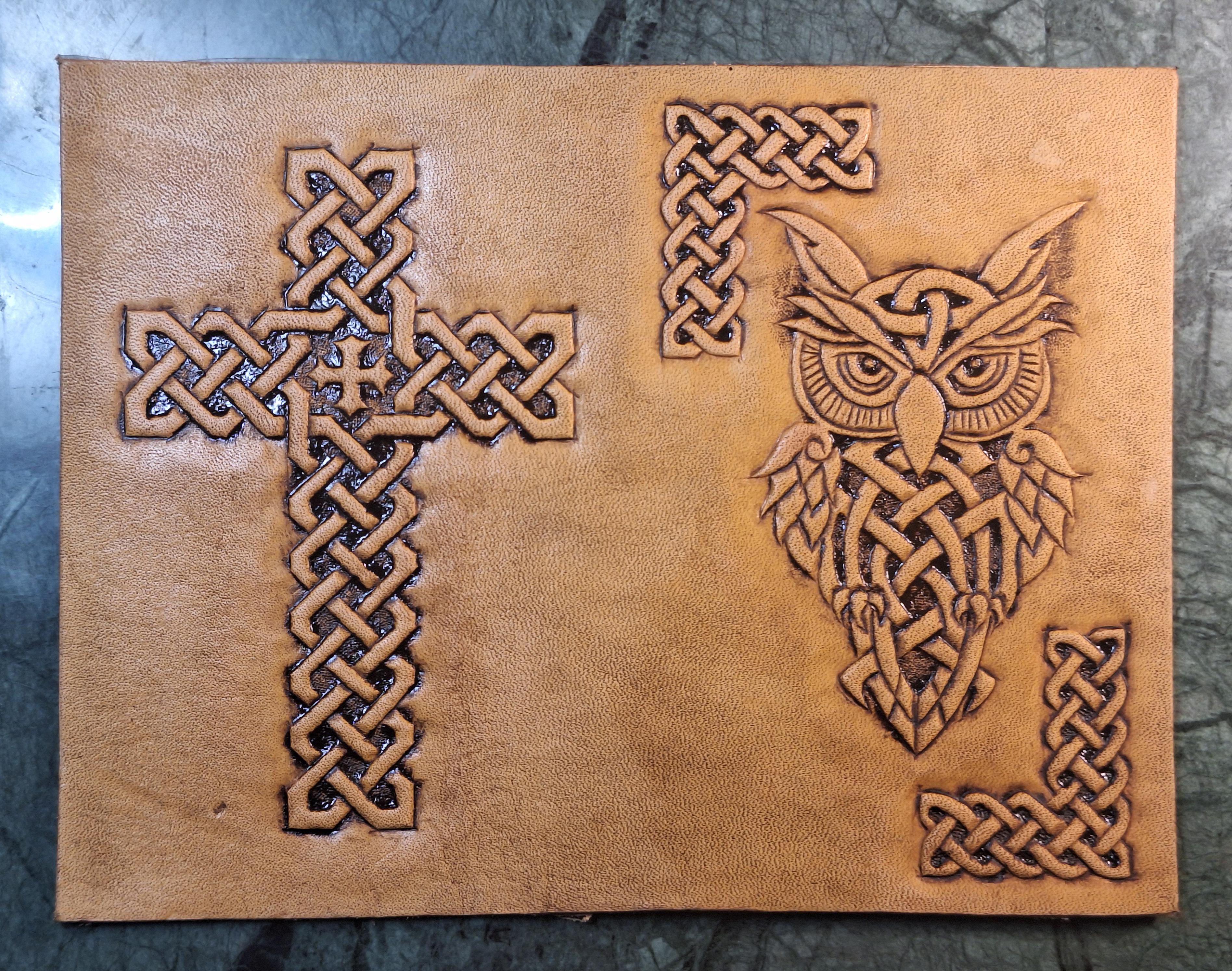

Thank you, There is something special to walk where things happened, I love history. Finished the tooling, waiting on the antique to dry. Will finish in the morning. Had to much open space on the rear to leave.
