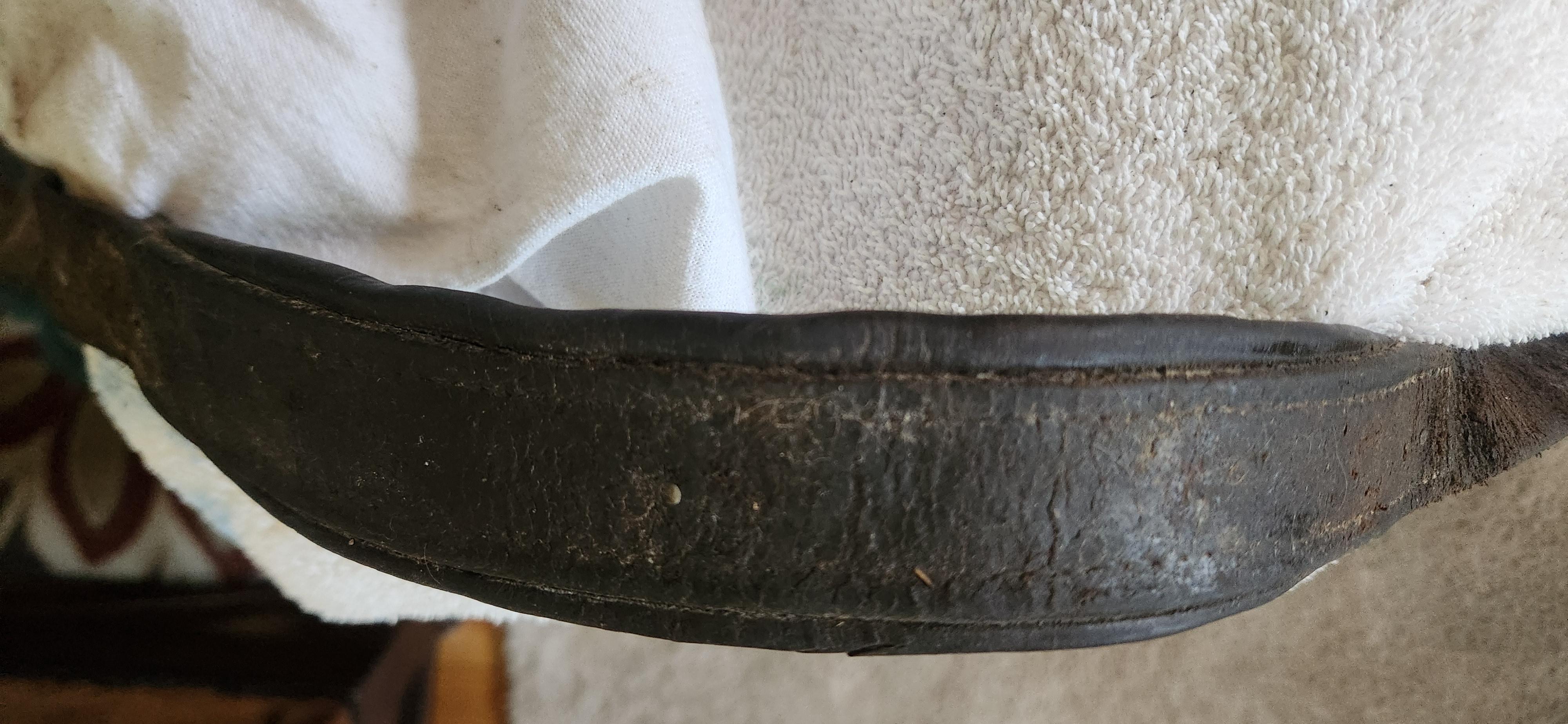

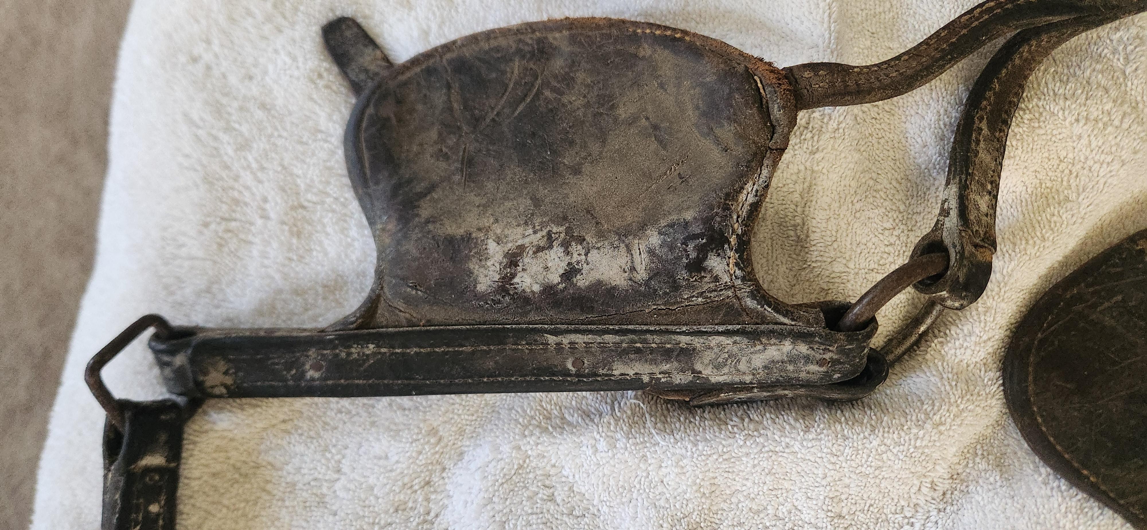

Hi thank you so much! It wouldn't let me add photos but I have attached ones in this reply. The last photo is the test photo and I also included the brown that was coming off as well as my products I'm using. There's still horse hair and hay from the last time they were used and so I don't know if I'm taking off leather or dirt. Thank you for your help!

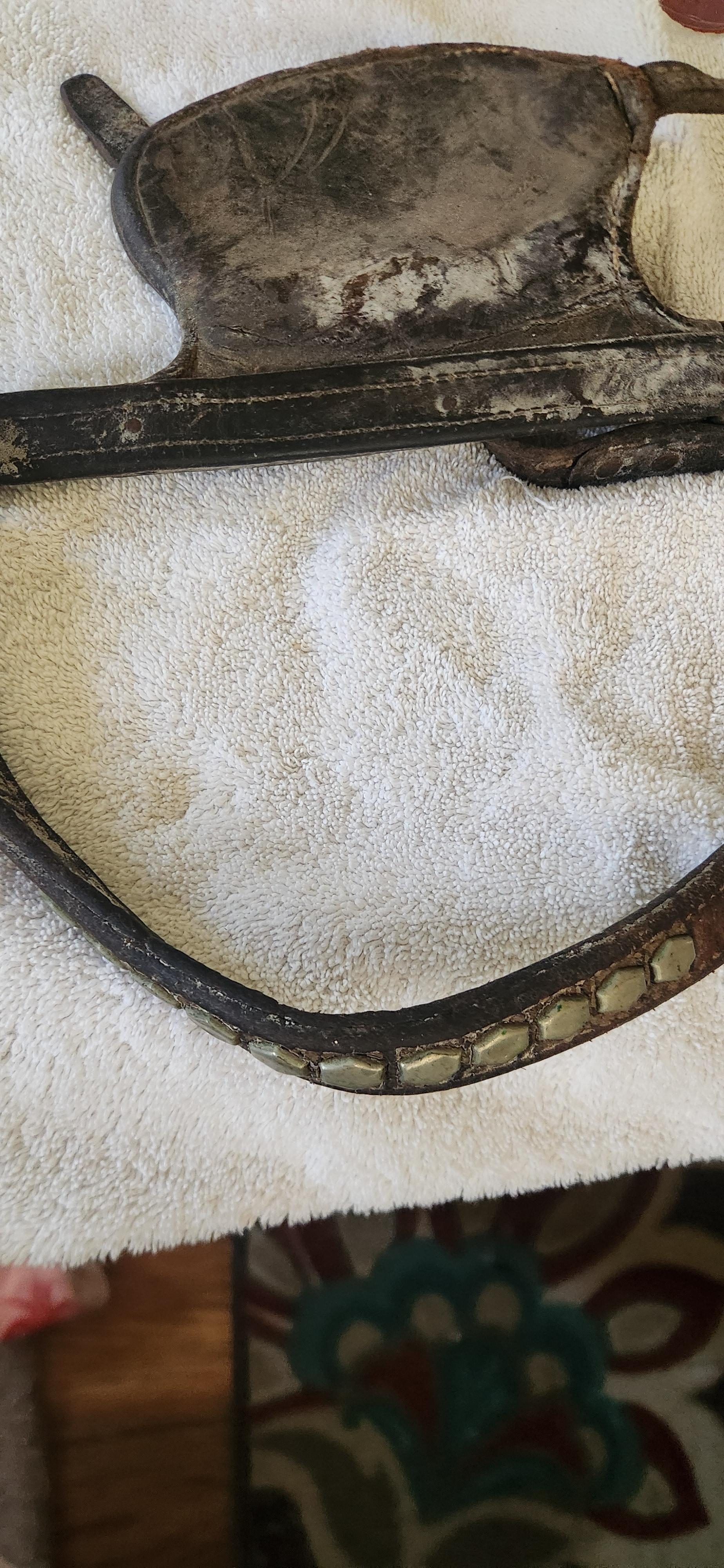

@cowagonwheel I would ad a caution that leather harness that old with unknown care should most likely be retired for display only. Really bad things can happen really fast if harness gives way while pulling a load. You didn't say if you were cleaning for use or display so I thought I would throw this out there. Todd

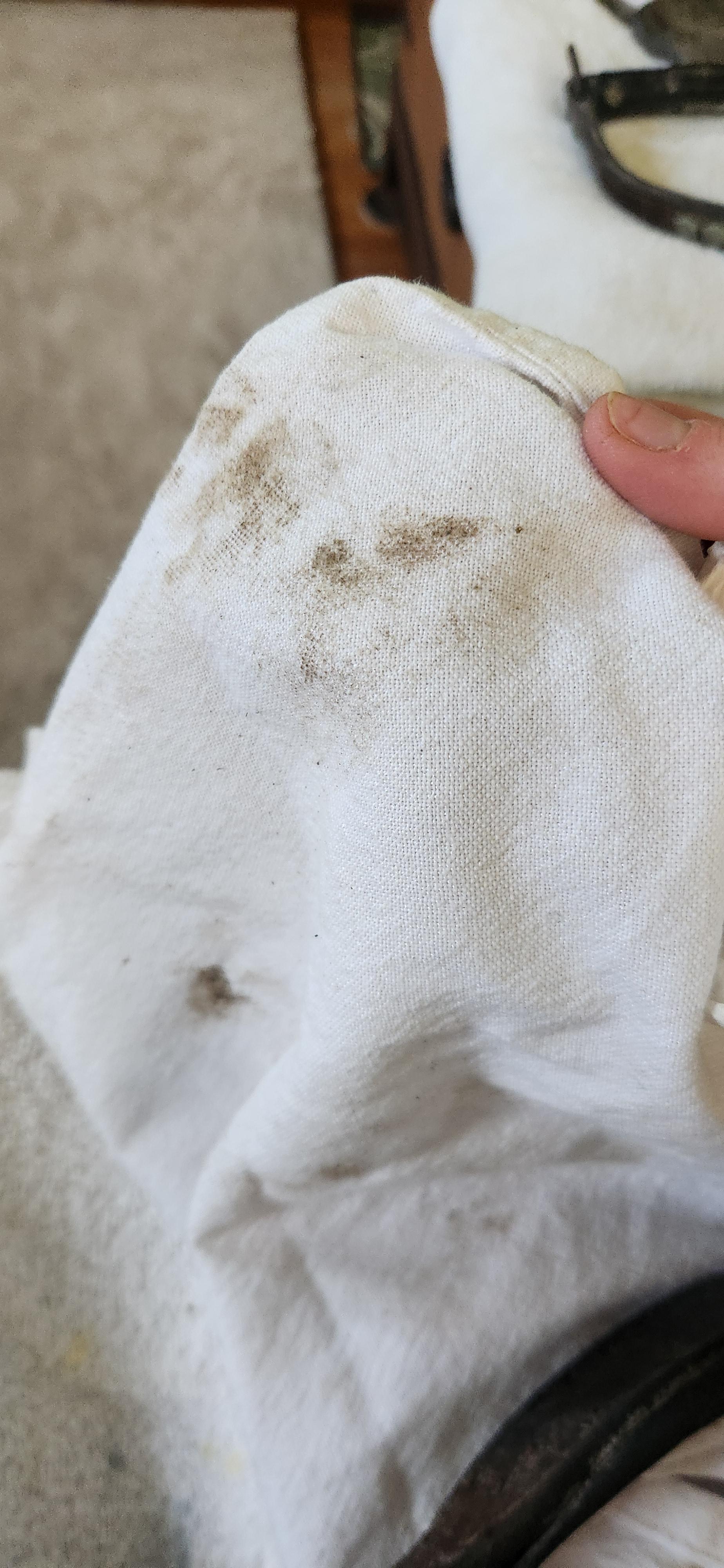

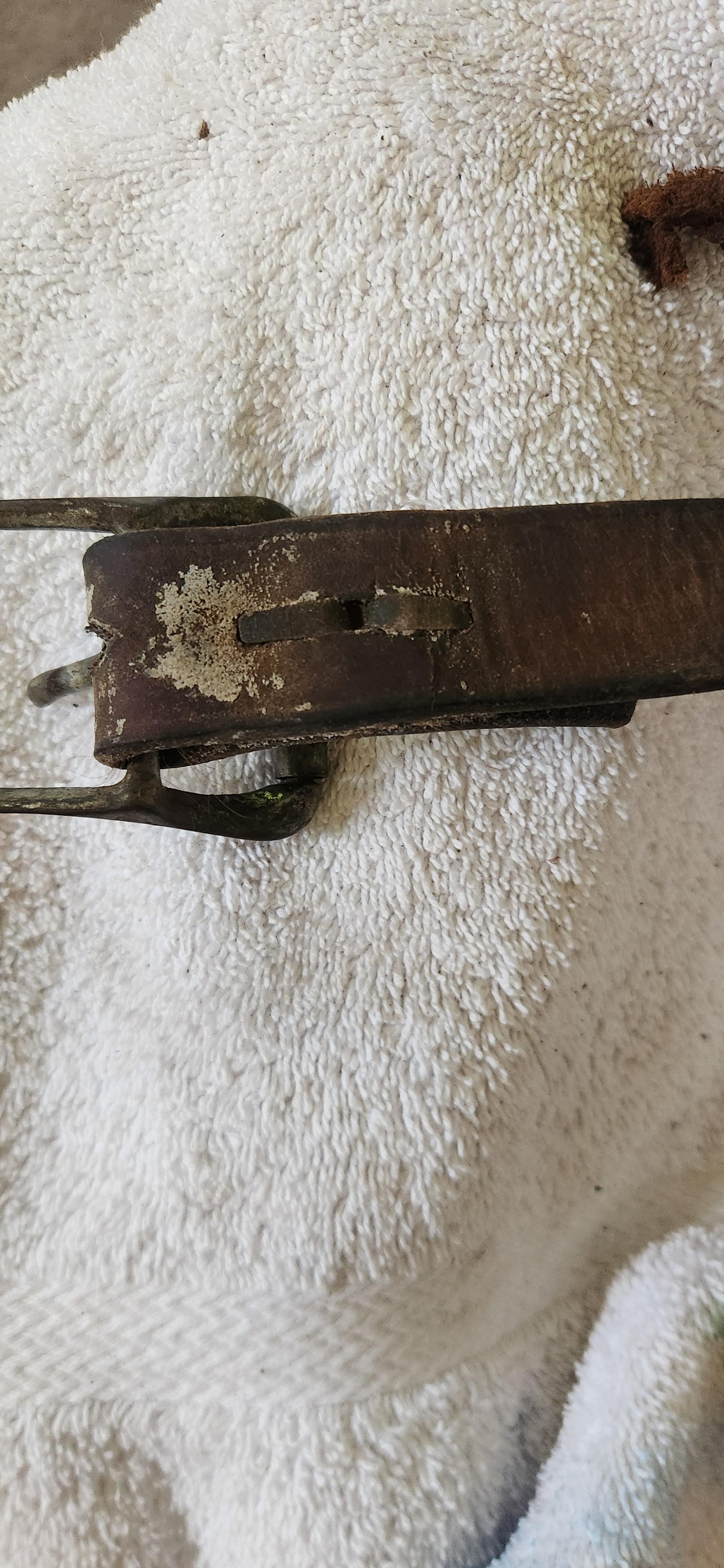

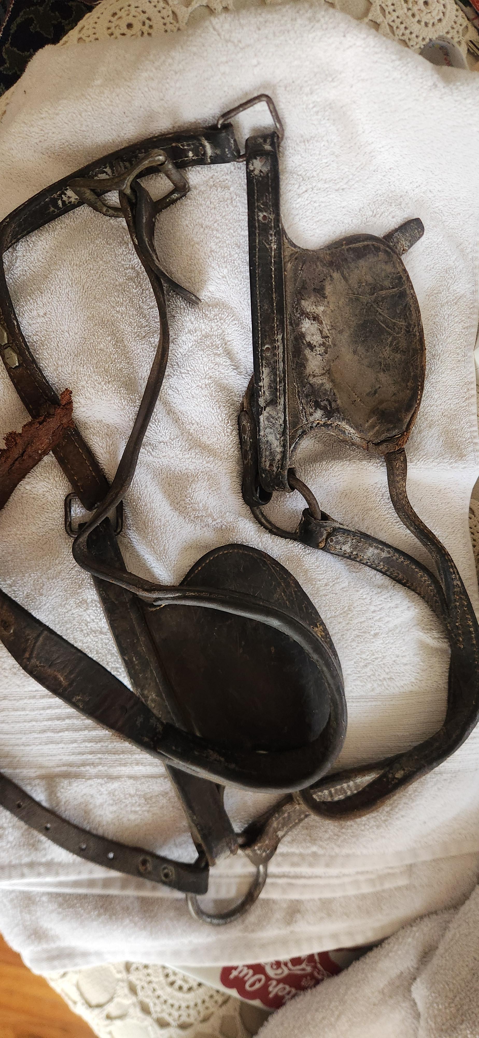

It's hard to determine what the white is without pictures. It could be mold, sweat, dirt, wax, or some type of chemical. When washing down saddlery it's common for the dye to rub off. Leather becomes soft when wet and can be indented easily, let it dry completely before putting unnecessary pressure. First thing I do when a saddle comes to my shop is to brush as much of the dirt and grime I can. As I'm cleaning I start determining what needs to be replaced or repaired. I can do small repairs and replacement but if the saddle needs to be broken down I don't take on the job. Normally I remove the stirrups completely but these would not come out and if they were going to be this difficult removing they were going to be harder to get back in. I then start to wipe it down with warm water to get any mud off as well as softening any waxes. I then go at it with saddle soap, warm water, and a sponge or toothbrush. I wipe it down with warm water as I go so the soap doesn't dry on the saddle. Once I'm satisfied with how clean the saddle is I let it dry for at least a day. Then I oil it with neatsfoot oil and let the oils soak in for about a day. At this point I determine whether or not to add some dye if to much dye came off while washing it and let it dry. I then wax. I use Fiebing's Leather balm with atomic wax and get great results. Before After washing and letting it dry After

Brasso. Or tamarind paste. Rinse both out well once clean.

In the kitchen for stainless I use: 1/2 Quart Water 50ml Hydrogen Peroxide 1oz Citric Acid I don't know why the mixed units. That's just how it came to me. Do your own research. Prolonged exposure to citric acid will leach zinc from the brass.

Hello everyone! After a death in my family, I recieved my family's very old draft team harnesses. Initally, I know they were stored in a basement in a darker area in a plastic tote. And honestly I don't know if they have ever been cleaned in their entire lifetime. Upon examination, it looks like they have white spots all over. After many hours of research and gathering my materials I started with 2 tests to get the white off, only on a very tiny spot. 1st: Using a hair dryer on low heat and far away from the leather I was trying to see if the white was fat spores coming up. Some did go away while other parts of the white stayed. 2nd: I used a vinegar and water mix and let it dry on it's own, then used saddle soap. After the cleaning step, my next step was to use pure Neatsfoot oil to condition then a neutral leather shoe polish with a horse hair brush and canvas. BUT during the process of cleaning I noticed the leather was almost "molding" and moving itself very slightly( as i touched it with my finger, my finger left a very slight indention.) Also, when I was dapping up some of the moisture from the saddle soap test, the rag had brought up brown. Again I don't know if its dirt or leather. On the test part, where I had originally seen very faint stitching had disappeared. I don't believe the stitching is gone but I did not want to go any further and risk the chance of So so sorry for a long explanation I just wanna make sure I explained it correctly. Is there other methods I should try? Or should I only condition them and leave them be? THANK YOU!
