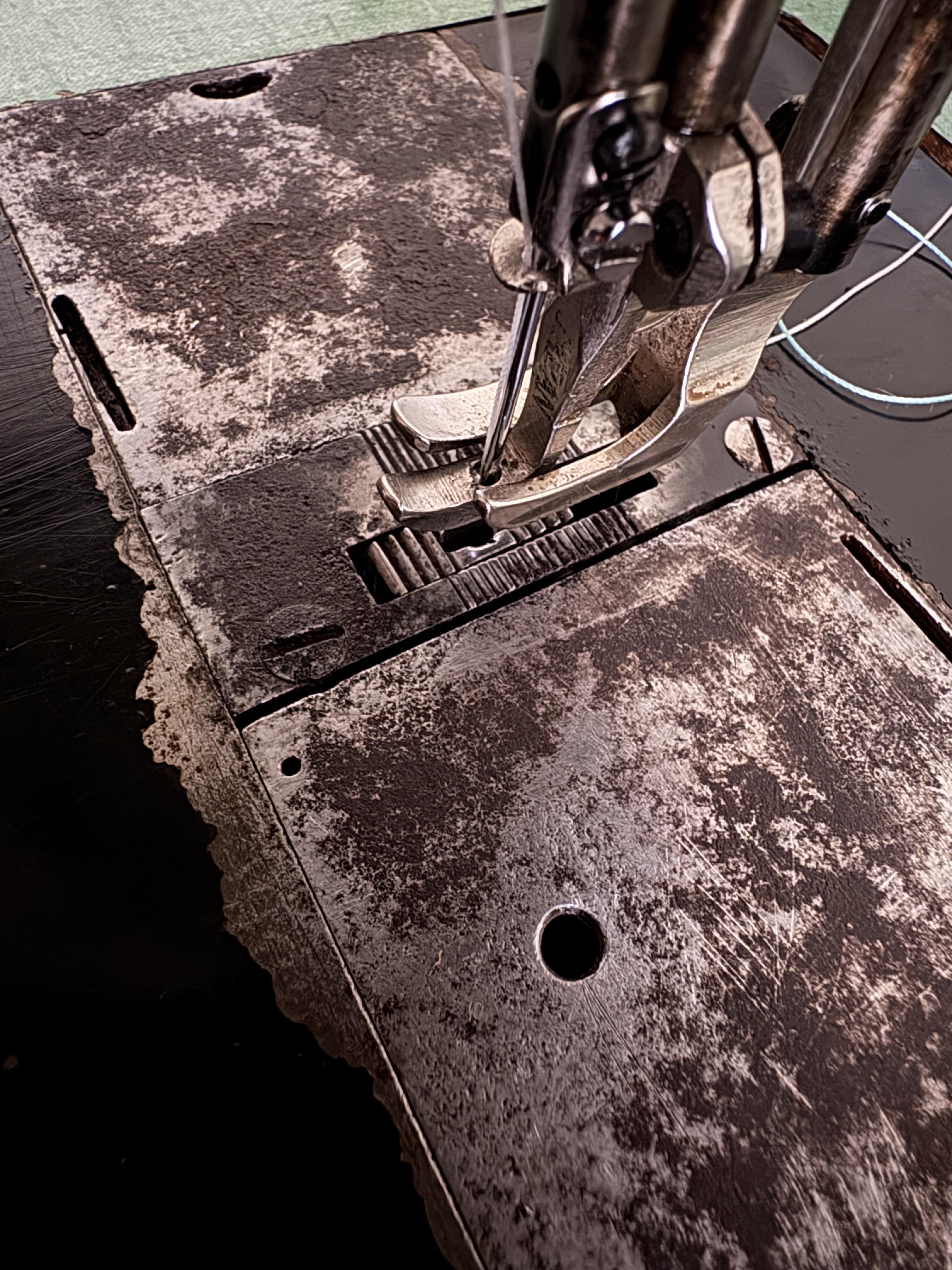

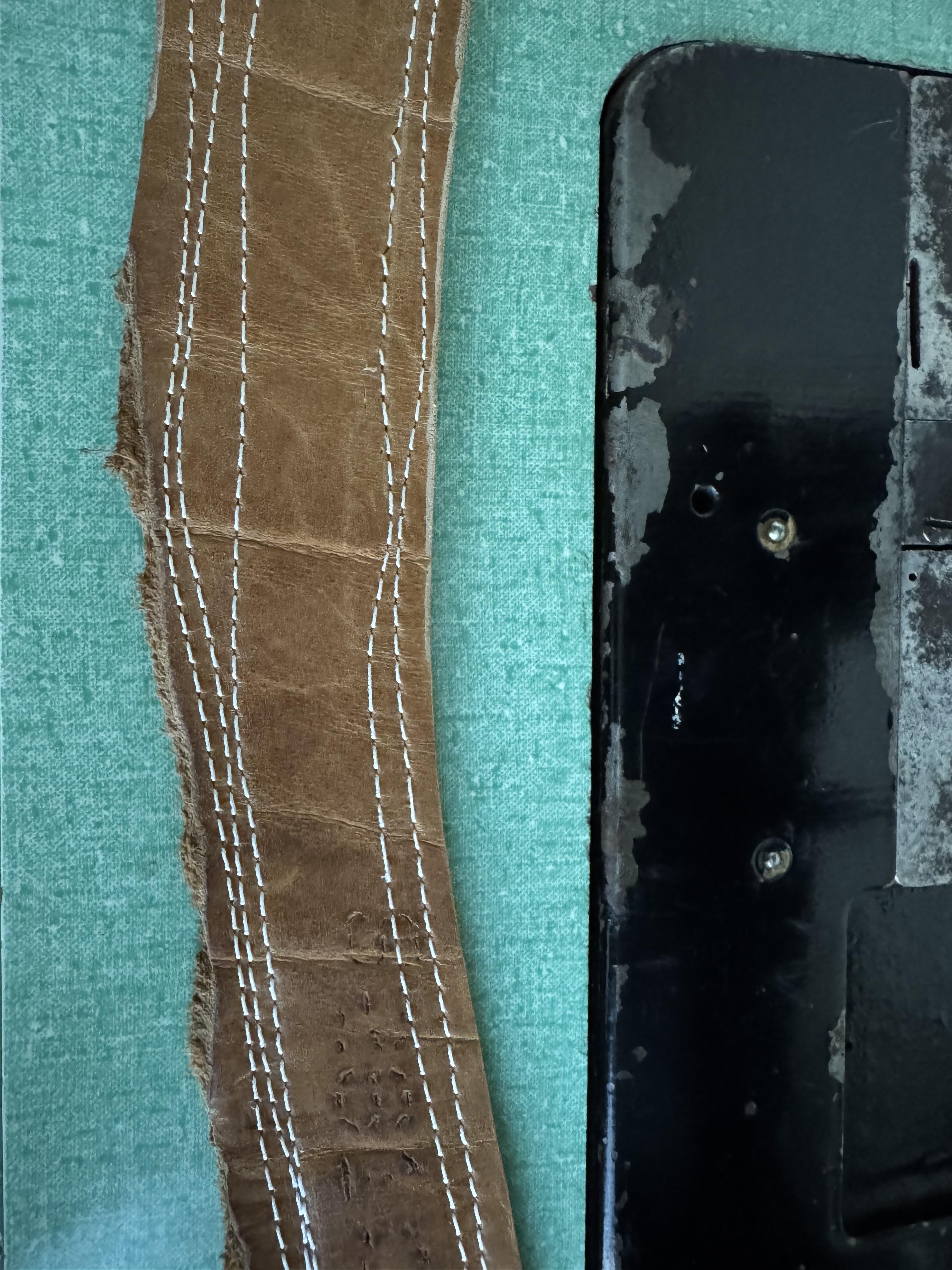

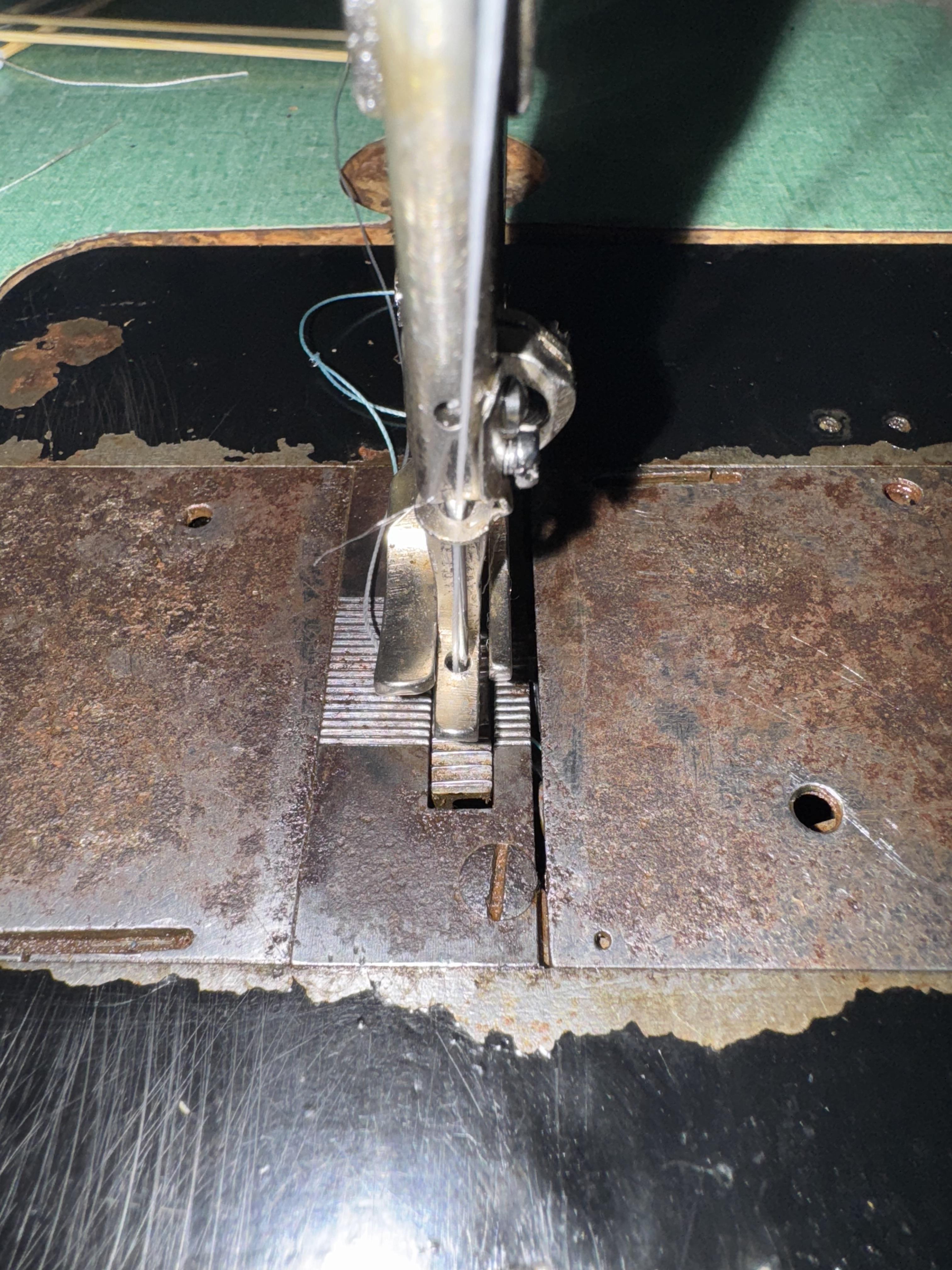

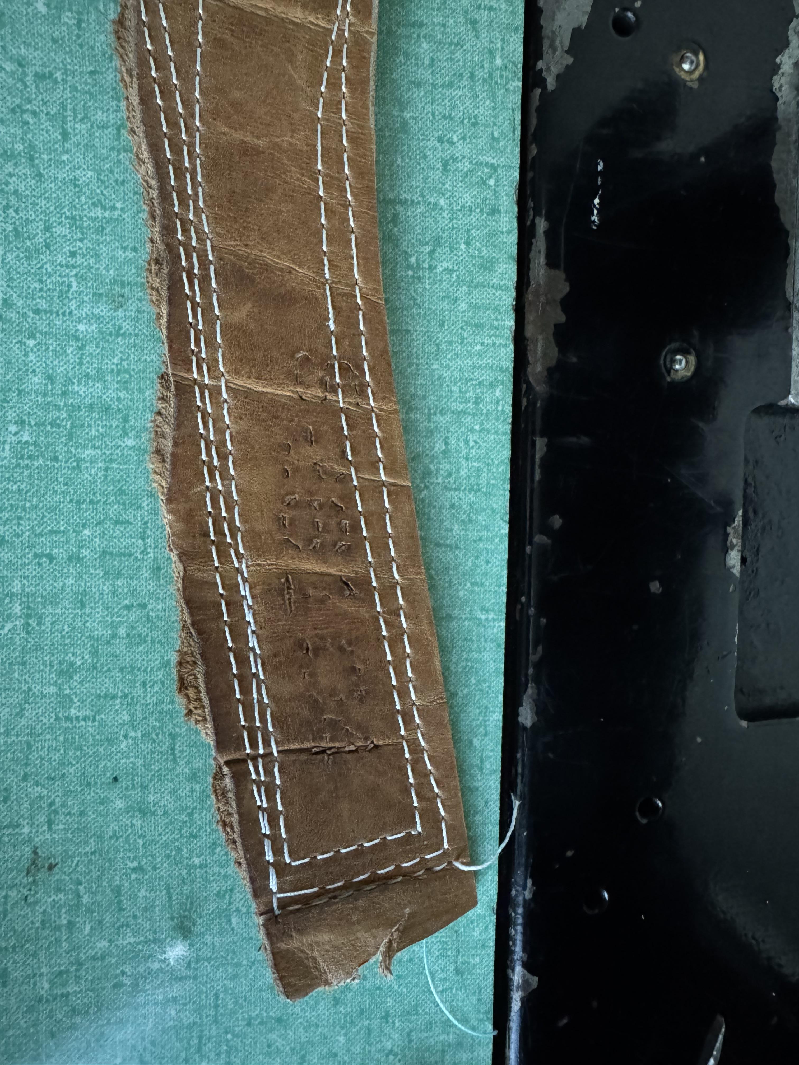

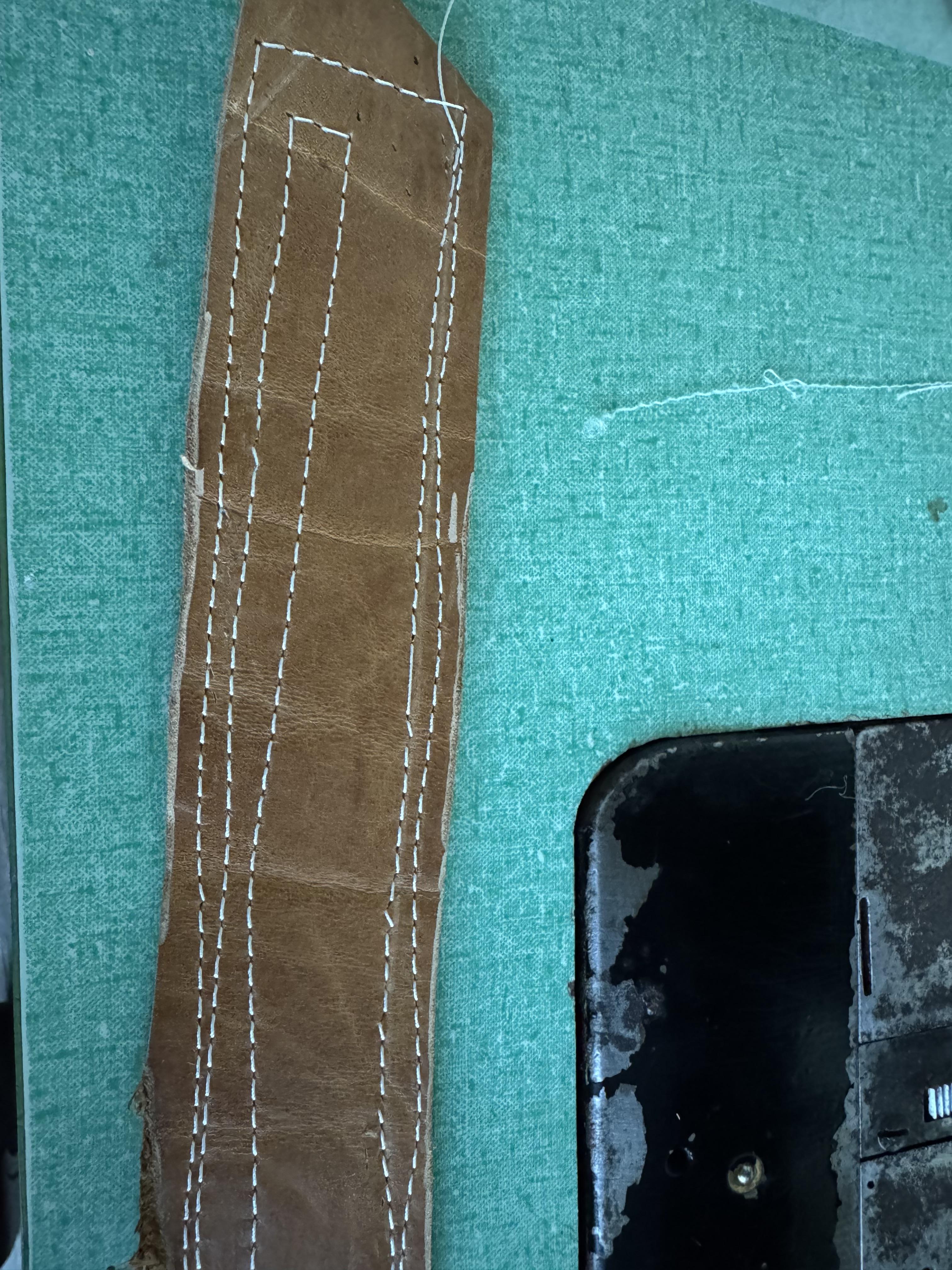

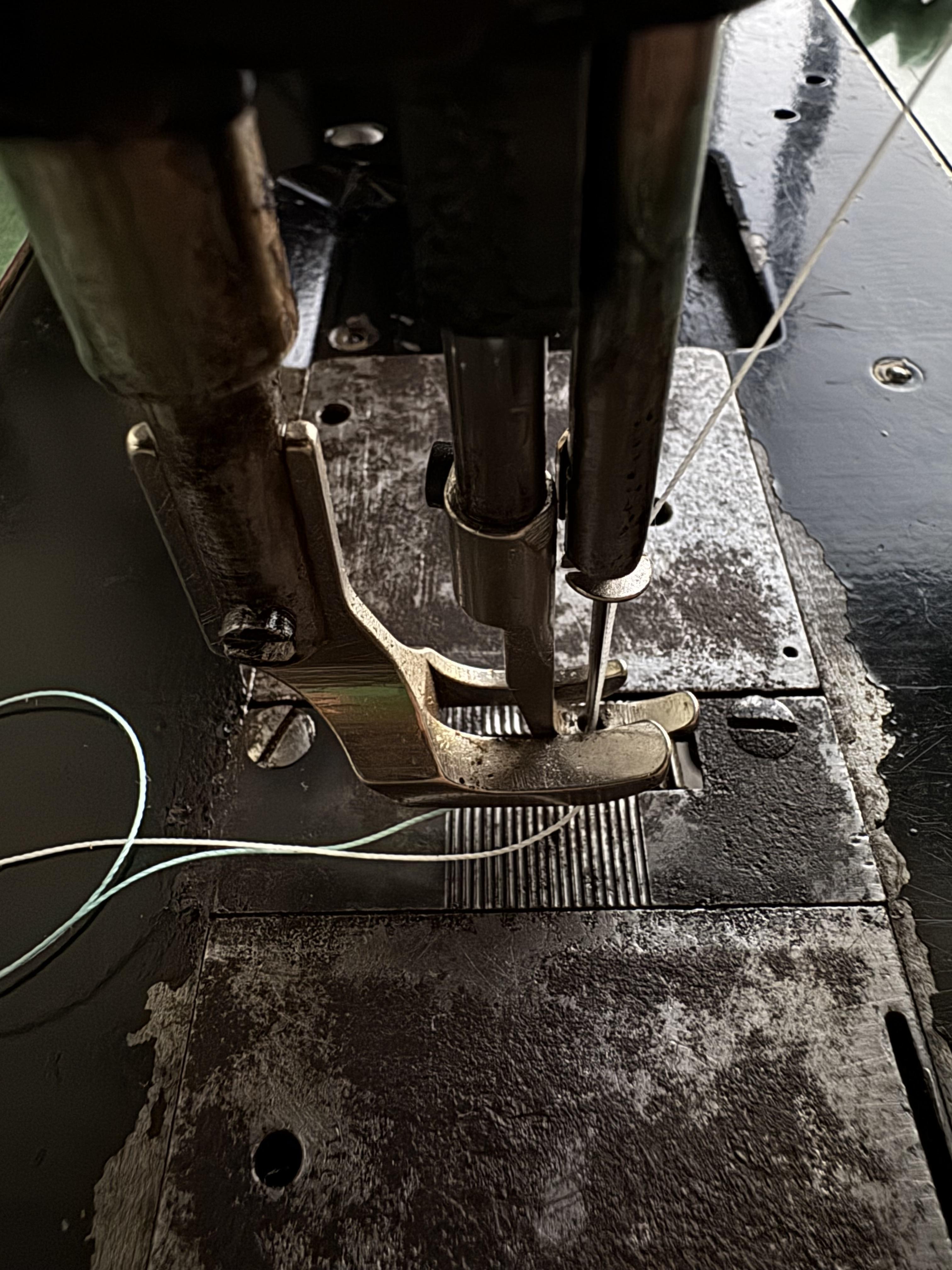

@AlZilla @kgg Thank you both so much for the advice. I followed all of it. Switched to 135x16. using a size 20 needle with Tex 90 nylon. Made the needle face the correct orientation. Repaired the small thread guide at the bottom. I still feel like my needle is a little too close to the inner wall of the foot but worried to crank on it too hard. It’s sewing like a dream only have a small issue with it skipping every so often or another. Will post new practice pieces after. Again thank you so much for all of your help!
What country are you in?? A link to where you bought it would be helpful so someone else doesn't buy it by mistake. kgg
