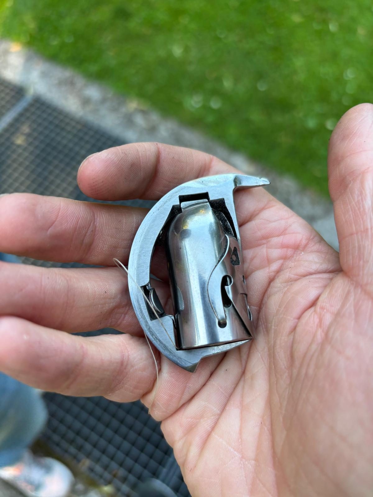

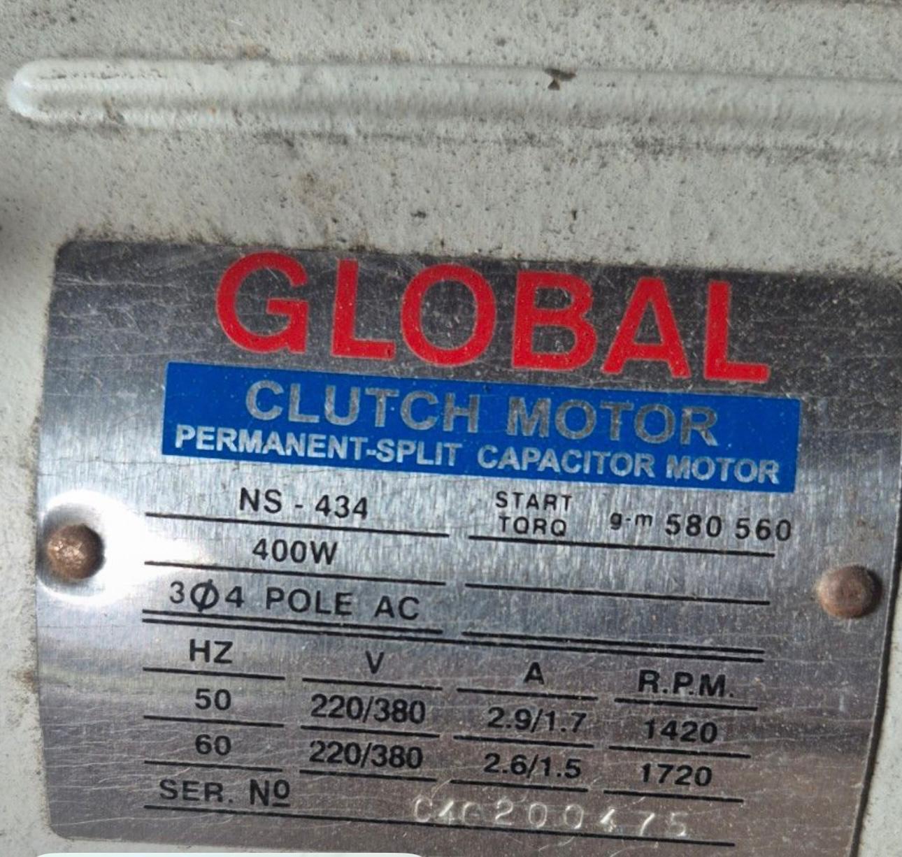

This is some great information! I already found that thread and read through it, but wasn't able to spot the differences myself. I wonder if it would be possible to source parts for the missing pieces, I'll have to look around for that. Thanks for the help! UPDATE on the machine, I seem to have been able to fix the thread from breaking. I will to try to explain, but to be honest I had outside help and have trouble grasping the situation myself. The clutch motor had a perilex plug (not sure why). I changed this to a standard 16 amp high current plug. I was unsure about what the effect would be on the machine but figured I'd have to make it work anyhow, since I don't have a perilex wall plug. I kept working with the machine this way, but realized that I should've checked way earlier if we attached the new groups the right way. Yesterday we switched two of the groups and voila, the machine was stichting! Now as you can see, while it is sticthing the lower thread tension is too low. So I went to adjust it. Interestingly the hook shuttle that is in my machine is also not the original (or the 27 subclass had a different one by design.) The original manual shows screw 47, that has to be loosened before screw 48 can be adjusted to increase or decrease tension. The manual: My shuttle: Everything seems to be going well thus far, sadly as I went to adjust the screw it broke 😔. Maybe I used to much force or it was just because of old age, but I had a small heart attack when it happened... So if anyone has any idea where to source replacement for that specific screw or just the shuttle, I would love to know!

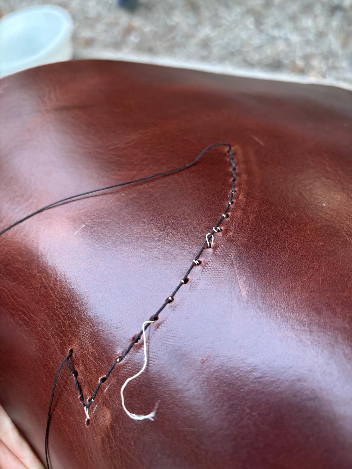

Personally I think what factors that are contributing / causing you to breaking the needles are: 1) Needle size: a 160 (#23) needle is meant for V138 thread in thinner leather. i) On a straight run a 160 (#23) needle may work as there is just enough room in the needle hole to allow for the 3 threads in the hole (1 for the top thread, two for the loop). ii) On a turn there isn't enough slop in the needle hole to allow the twisting movement and the bending on the needle. iii) When you are finishing off by reversing into the same last couple of holes you now have 3 stitches that are all ready in the needle hole and you want to add 3 more. In thin items this may not be as much of a problem but in 8mm (5/16") it probably will be ending with cutting the thread or broken needles. 2) Friction on the needle. i)When the hole isn't big enough, diameter wise, there is friction being created by the threads grabbing the walls of the thread and pulling on the needle. As the thickness and toughness increases so does the friction. ii) This friction will increase ever so slightly with darker coloured thread. iii) If you are using a edge guide the leather will not move sideways but when free handing you are going to add an additional twisting / bending moment on the needle. iv) Also when using a cylinder arm machine you get additional twisting and bending as the item moves farther back as most times the item wants to move to the left. Also unless you are using a flat bed table attachment the item will want to droop down once it doesn't have any support from the needle plate. Probably will be ending with a broken needle. Suggestion: i) Change needle to a 180 (#24) and see if that works. ii) change thread size to V207 and use a 200 (#25) needle. iii) Add a flatbed table top attachment. kgg
