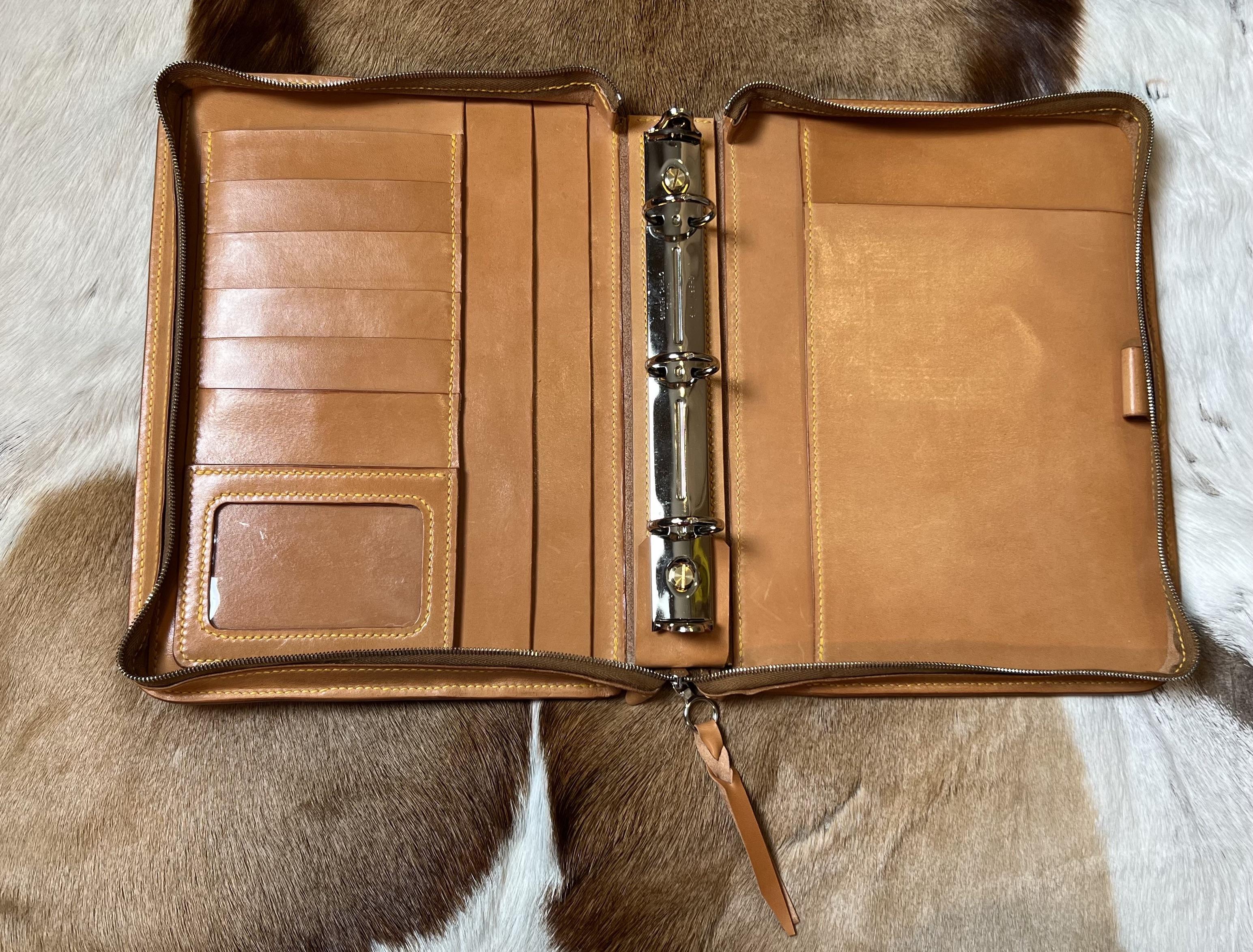

  2. I did finally manage something, not entirely happy, and will adjust for any future designs, but it worked well enough.

  6. Thanks for the compliments. I think a holster would fit but pretty soon you run out of waist. Well my son would, I have a little more. I have sewn across straps and learned the "tear on dotted line" lesson as well. It's a rite of passage. Randy
