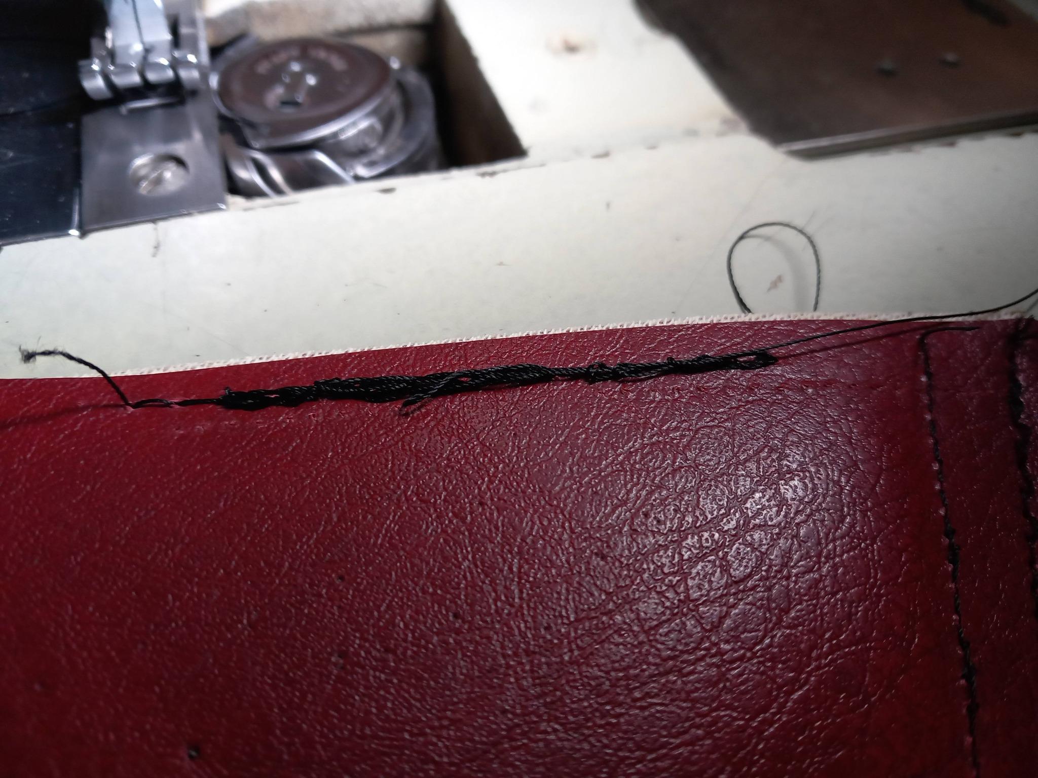

You have skipped stiches and a nest bellow? Have you checked the timing of the machine? here is one document, check the added text at the end https://docs.uwe.net/Pfaff-145-545.pdf you can also check different pfaff 1245 Service manuals which have nice graphics. It is much newer machine but certain things are same / similar etc

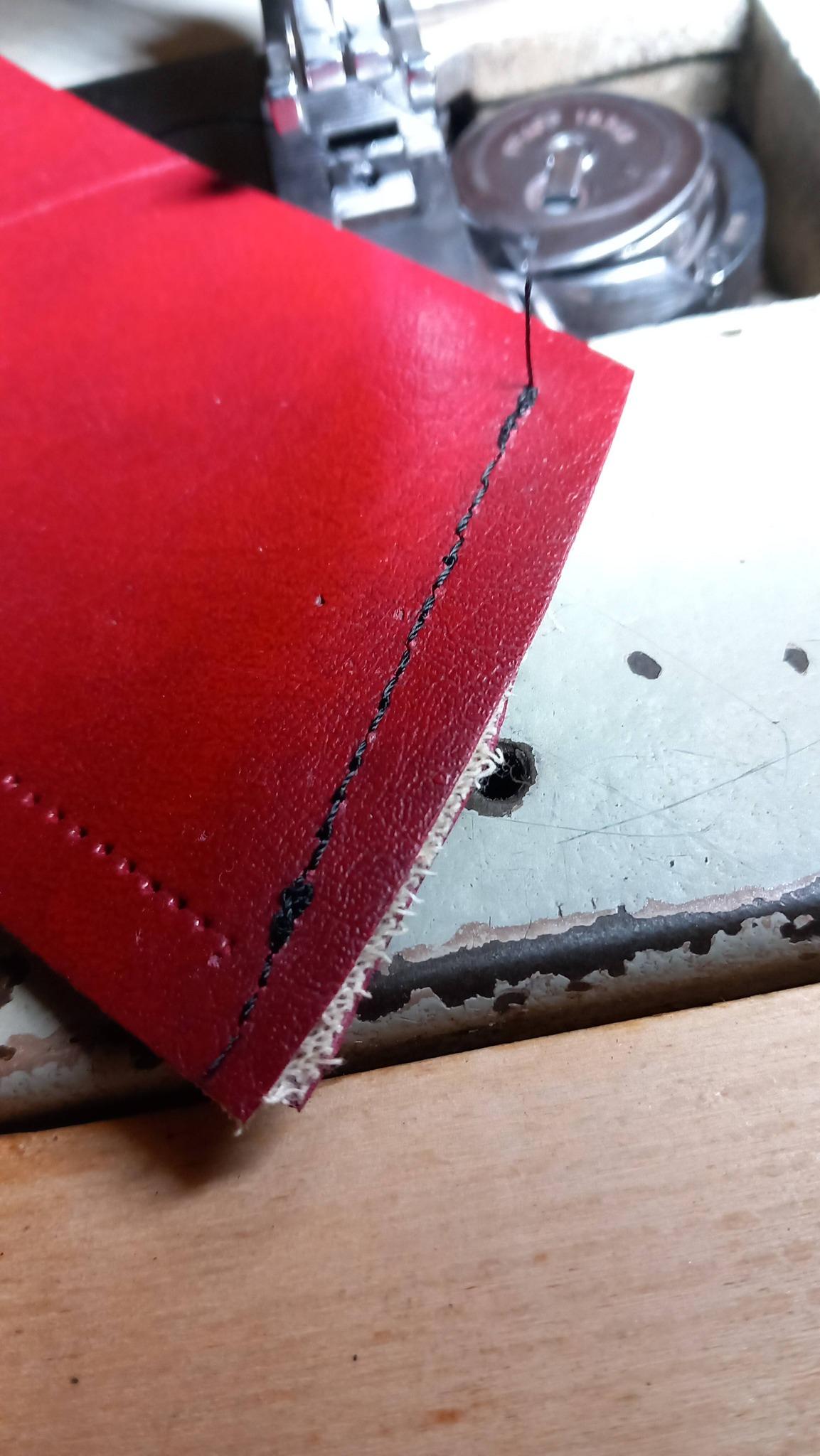

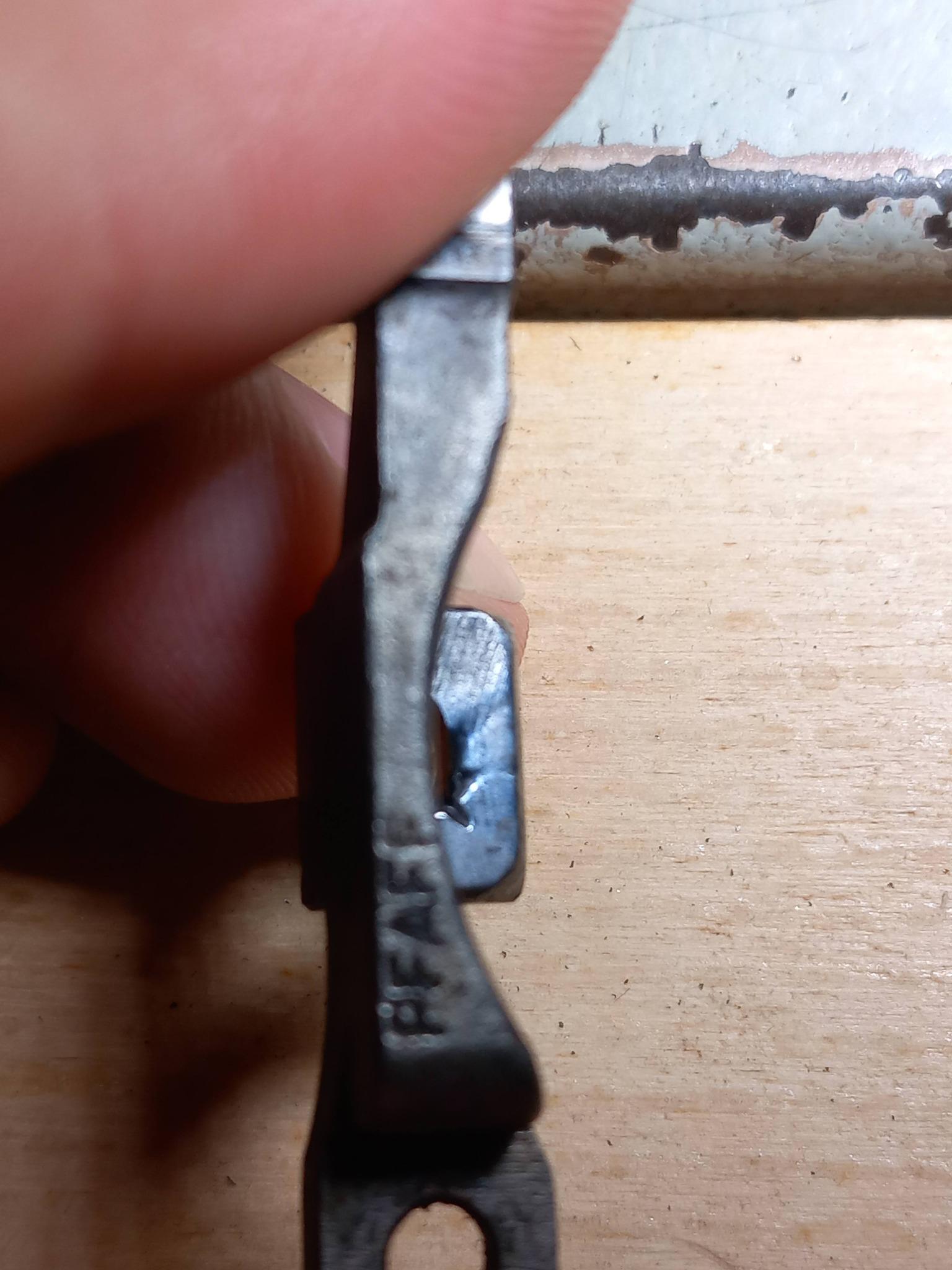

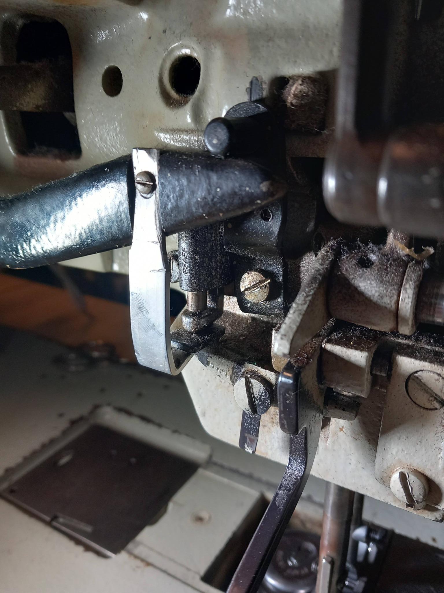

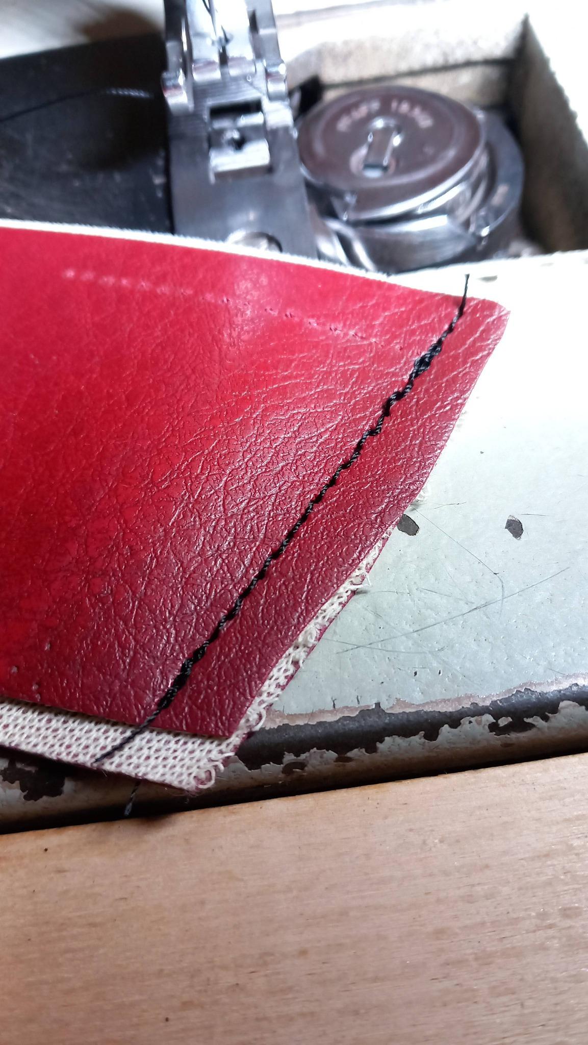

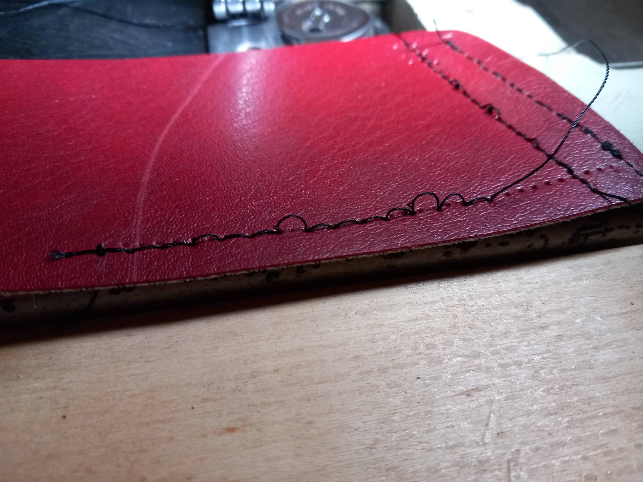

the good news is. i finally got it stitching the bad news is that it inst pretty or good. keeping the smallest stitch length its stitching just not good looking. but when i turn it up for longer stitches it starts messing up badly. so what does everybody think ? is it a tension problem ? any advice would be apreciated. i took apart all the stuff inder the needle i sanded down rough edges and cleaned everything. but didnt find any burrs or nothing. the under side of the feeddog had some carving that was weird in my opinion and everythime i used the knee lifter i heard a click and i found the problem. the bracket that helps take the tension of the top tread when lifting the feet was broken and the home made a piece that slips off and dont do much. so ill go look for a replacement for that. already spend 3 days working on this and i was ready to give up and bring it to a mechanic. but i learned they are hard to find. and the ones i called dont do it anymore only domestic machines. so that sucked. i need this machine to run and work for me. cant keep fiddling for ever on this. and dont have the money to buy another one and find that that has problems to XD
