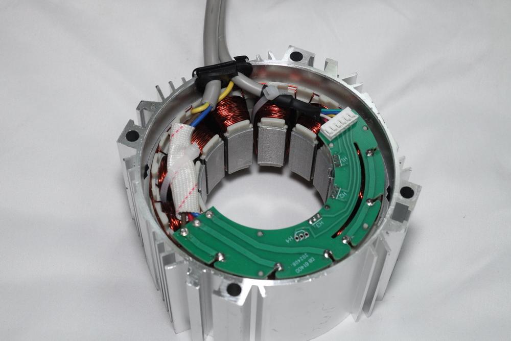

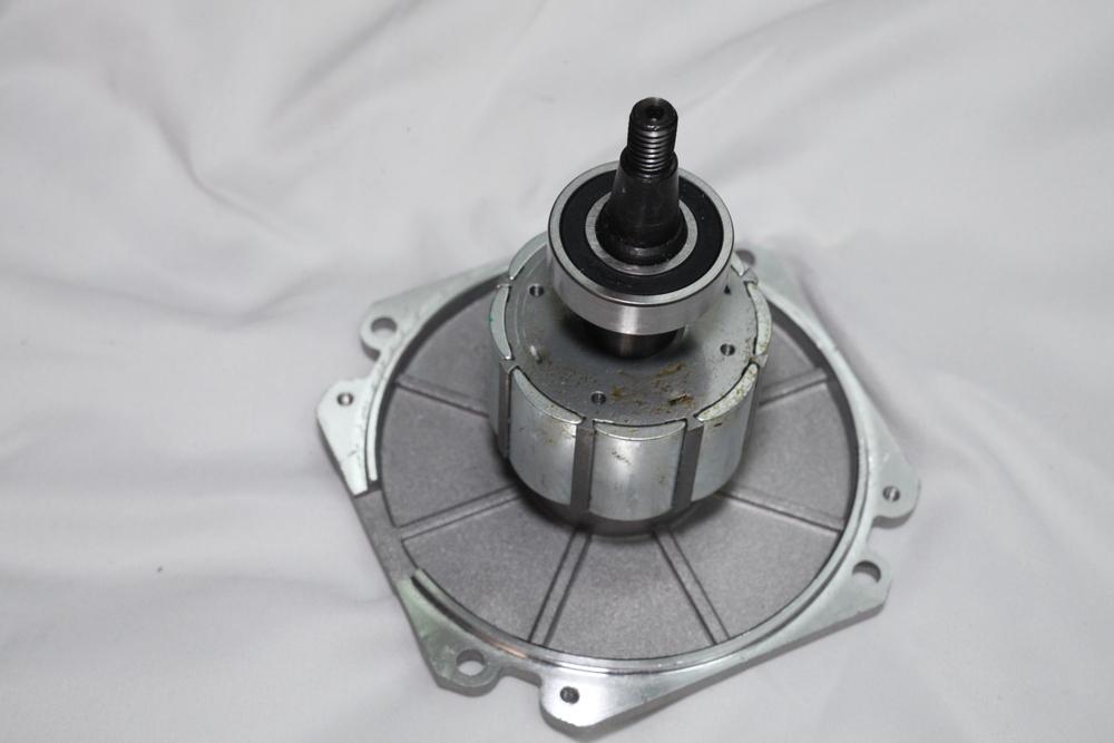

friquant replied to AlZilla's topic in Leather Sewing Machines
This is the stator and rotor from my "stitchman" digital servo. Only took about fifteen minutes to get it apart with a #2 philips on the screw gun, then a screwdriver and wrench to pry the plates off. Those permanent magnets are no joke! -

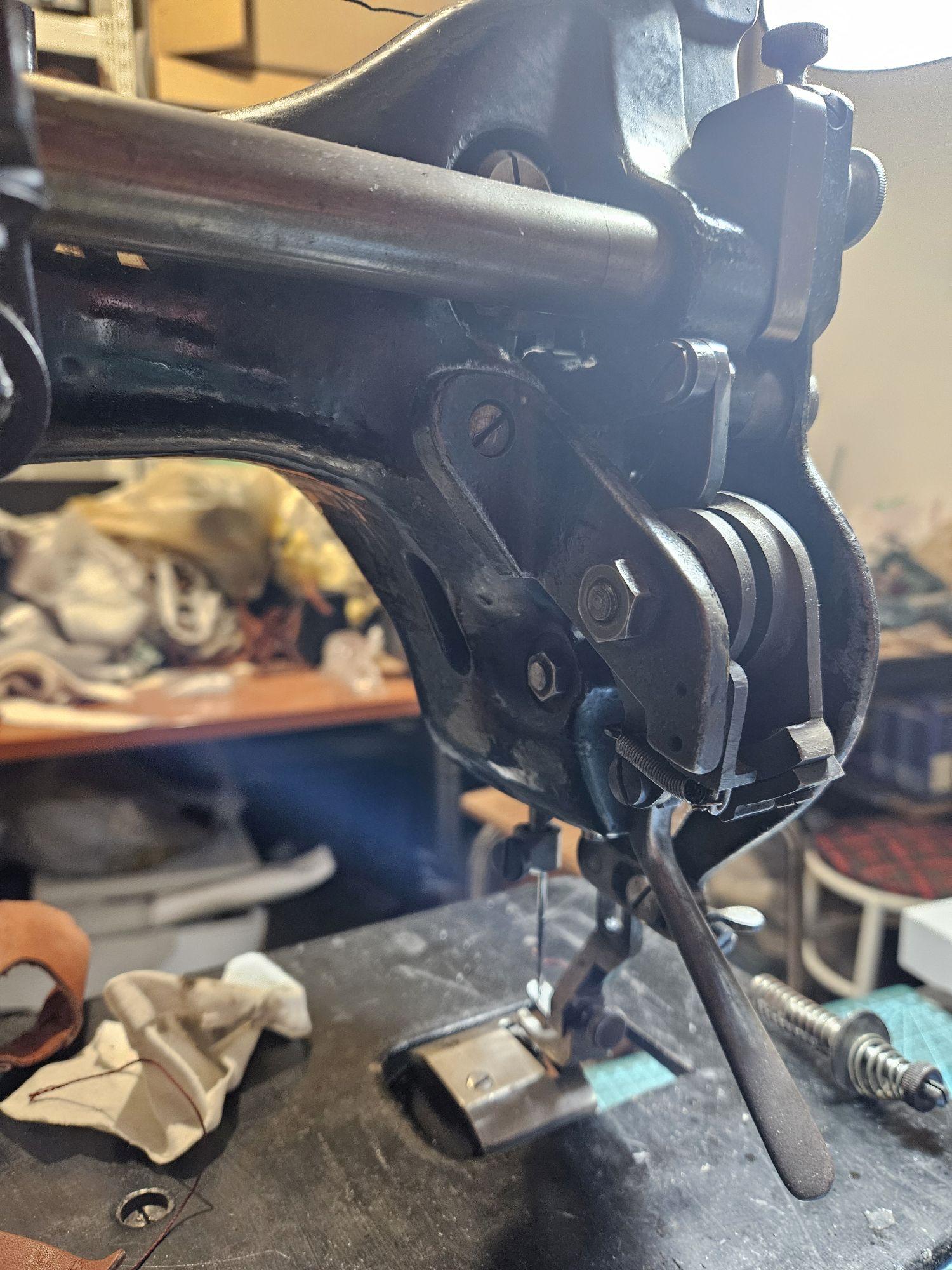

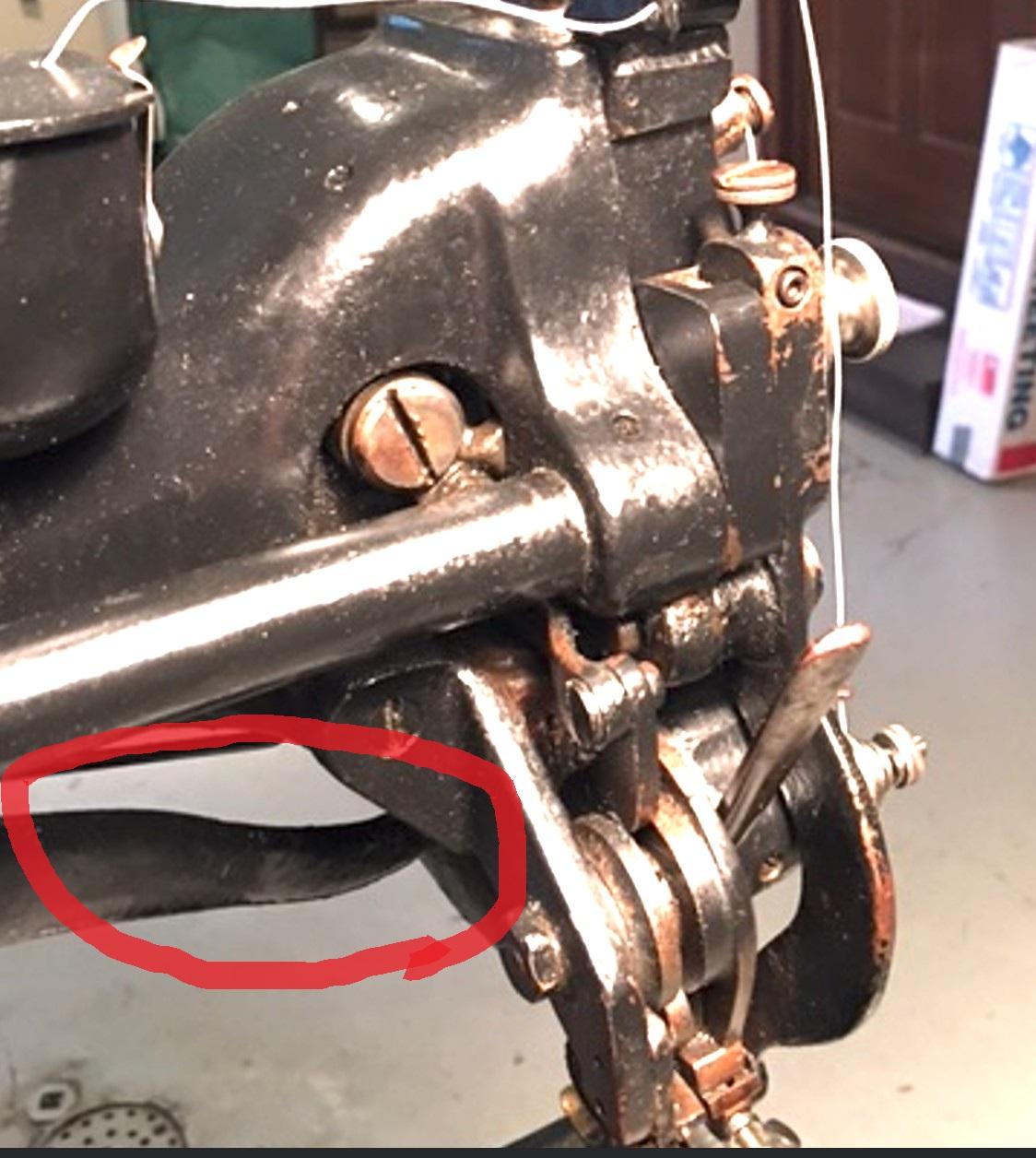

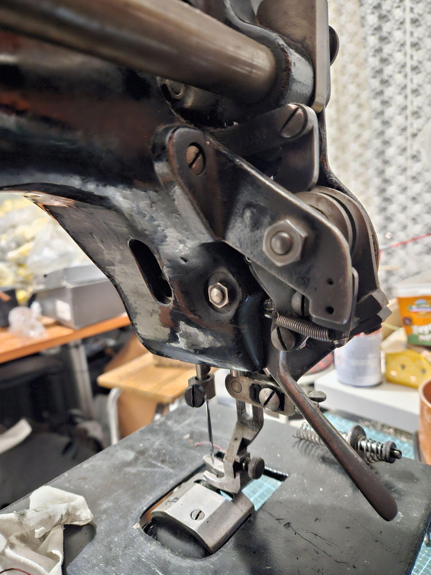

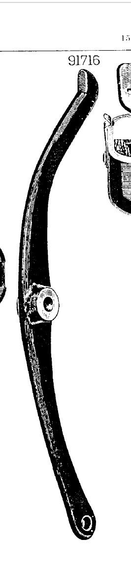

Hello, I have a question about my 45k53 machine, Since I couldnt find parts list for 45k53, I dont know how it would be but, I want to rebuilt foot lifter lever . I have also one 45k25 and I have completed rebuilding for 45k25 . From this topic , I have seen this photo with lever system And also I want to share my machine photos, I just want to learn the shape of part,in order to produce a utilizable replica of it. I think it should be a bit diffrent from the one 45k25.(part code 91716) If possible, Could you please share the photo of foot lifter lever for 45k53 (or part code of it) Thanks

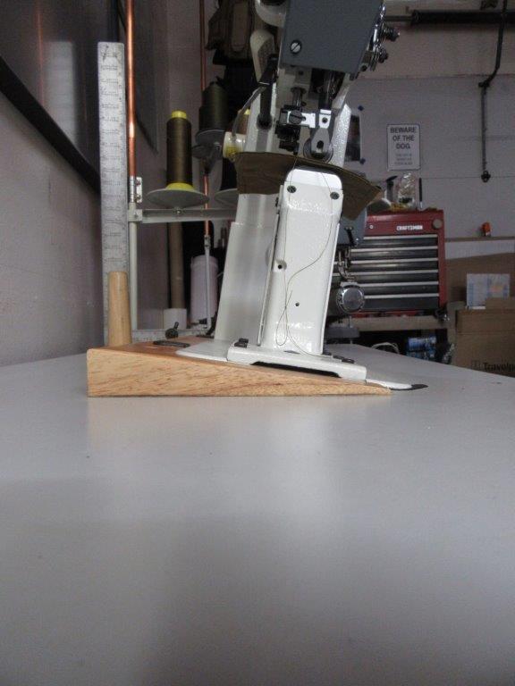

nylonRigging replied to Cumberland Highpower's topic in Leather Sewing Machines
Not a Tall extra high post, but the slight shim tilt forward modification to the sew head is more comfortable on sitting behind with eye-hand, and you dont find yourself leaning forward as much . - - -

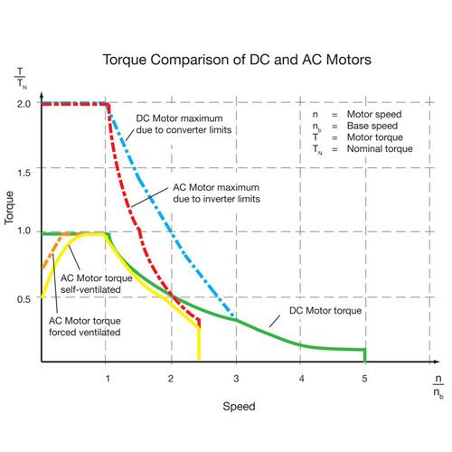

I guess the problem is with the minimum speed to start. Which is I guess an engineering characteristic of the motor, but this is beyond my limited knowledge of electric motors Regarding torque of different types of motor I found this:

Oddly, most everything I've seen about the cheaper servos is that they lack torque in the low end. I don't know ...
Those are very informative charts. I'd really like to see the same data on lower end servos.
of course they have, this is from Efka site: which shows that torque is more or less flat in the lower part of the rpm. It also shows that they have two different servos, one built for speed and the other built for torque. The power is function of speed and torque: P [kW] = (T [Nm] · ω [rad/s]) / 1000 in lower speeds where torque curve is flat the power is increasing constantly with speed. Later it can decrease slightly (depends on the turning curve of torque). Of course when the speed is 0, power is also 0. And because of engineering reasons the motors have minimum speed at which they work.

Everything I read about digital servos says they have high torque from a standstill. My digital servos with 200 rpm minimum speed start with lots of torque. It would be educational to have a digital servo that was fully programmable so we could try some experiments at very low speed. The control box on my "stitchman" digital servo has what looks like a 9-pin serial cable, but I have not checked to see if it's actually sending serial (UART) data across the line.
