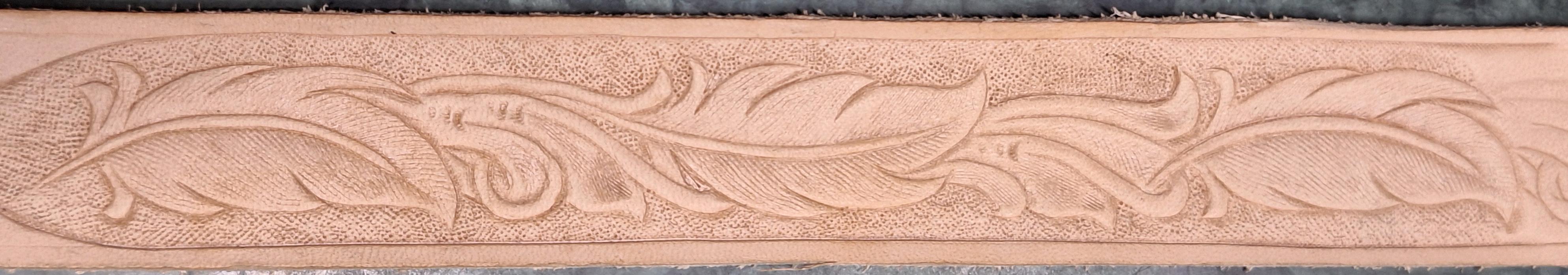

The knife has my utmost respect. Feeling a little better and wanted to tool a bit. Making a 1 inch hatband for a special hat. Not sure how it will be finished, painted or just antiqued. Waiting till 100% to get back on the wallet, hate to mess it up.
