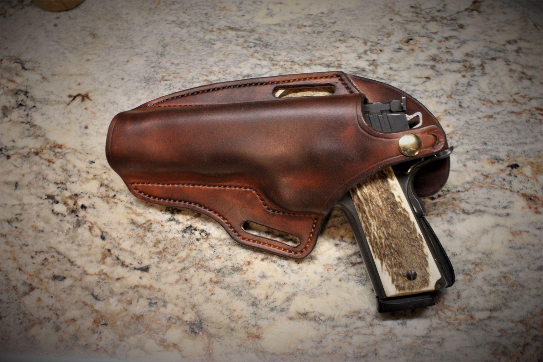

chuck123wapati replied to Stetson912's topic in Gun Holsters, Rifle Slings and Knife Sheathes
I've been using a heat gun to "activate" contact cement - just a brief warming of the glued pieces before assembly. Bonds well with less cement so I have fewer problems with the glue interfering with burnishing edges. For some shaped pieces I case the leather lightly and shape the leather before applying the glue, and the heat gun treatment results in a better bond when the leather is damp. I'm using Barge cement but will probably switch to Weldwood in the future.
I do that as well, but one thing I do differently is that I keep two jars of contact cement, one of which is slightly thinner than the other. The thinner is for the first coat. I also work in a good tooth on the leather. The first coat must be dry; then apply the second coat. then I press and hammer together. The only contact cement I use is Bardge cement and thinner. I have never had a separation. Bardge contact is as strong as it gets.
For the base (black) I would use a pro dye instead of paint. The dye penetrates the leather where the paint will sit on top of the leather. You can still use your paint gun for it too. I can't tell for sure, but it doesn't appear the edges have been burnished. This will also help protect the leather over time. By burnishing the edges, it will seal them to prevent moisture from intruding into the leather, and it gives the piece a nice finished look. Nice job on the shield. Especially like the concho.
I use Welwood contact cement. I also have this other glues but Weldwood is awesome
I started with Barge contact cement and have tried some other leather glues, but always come back to Barge. It is probably similar to weldwood, but I am gonna stay with Barge.
