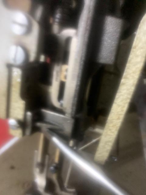

Many walking foot machines have a bracket the adjust for left & right movement of the whole needlebar assembly.See the attached pic there are 2-screws behind it to loosen & hold it against the bracket & re-tighten if you need to.
