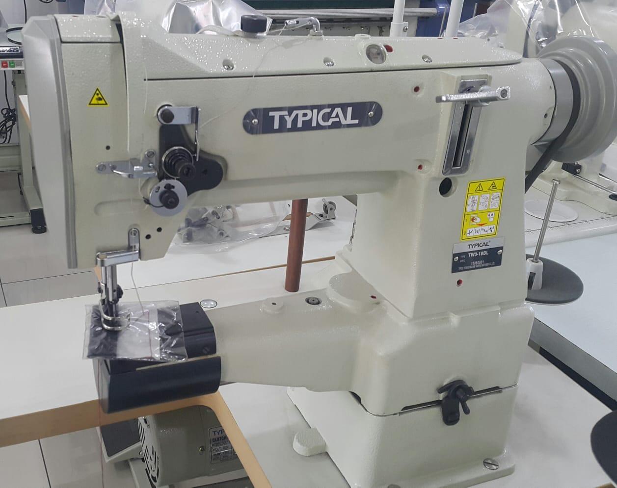

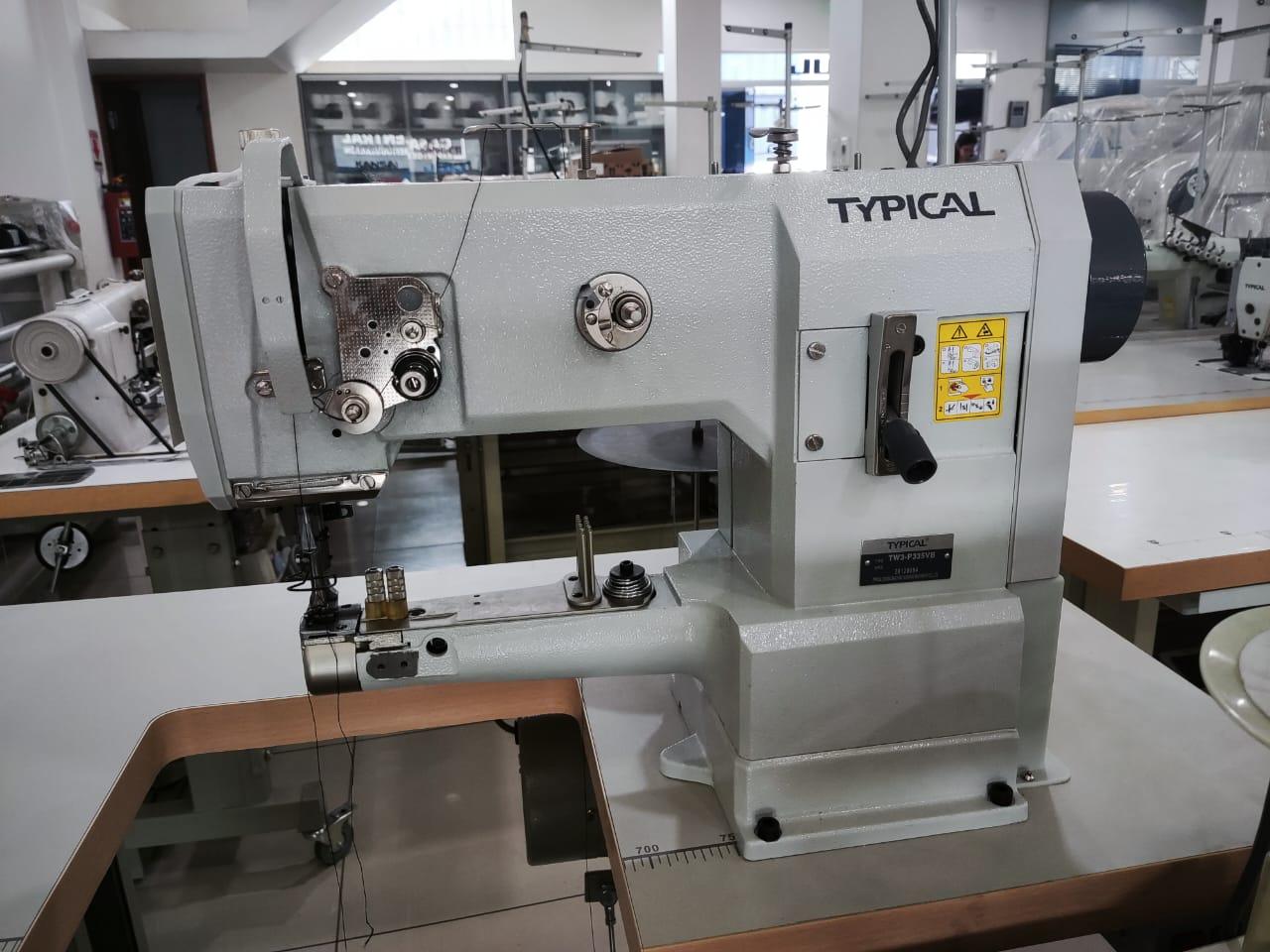

I've been researching a lot on which sewing machine to buy and I came to the conclusion that my first machine has to be a cylinder arm machine if I want the closest thing to a sewing machine that does it all (since I can only afford one atm). I've been watching videos and lurking this forum and reddit but still unsure since some people warn against getting a 335 model for leatherwork, but then again you mostly talk about sewing thicker veg tan leather. all I'm going to sew is thin to medium thickness chrome tan leather bags, briefcases, wallets and accessories with it. I went to the sewing machine store and they only have these two: typical tw3-p335vb is about 1.500 us$ converting to US$. 650w servo motor is 100$ more. the non-binding needle plate and feed dog is an extra 30$ this one is for binding but I've seen some people use it for leather too user manual: https://www.supsew.com/download/typical/Typical TW3-P335 Parts and Instruction Manual.pdf typical tw3-18bl (about 2.300 us$) 650w servo is 100$ more. this one is a proper machine made for leather. idk if it's gonna be able to handle thin leather though. user manual https://www.supsew.com/download/typical/Typical TW3-18BL-28BL.pdf the difference in price is huge for me, in fact the typical tw3-18bl is a bit over my budget but if you guys tell me it's the right tool for the job I'm willing to save up a little more to get it.

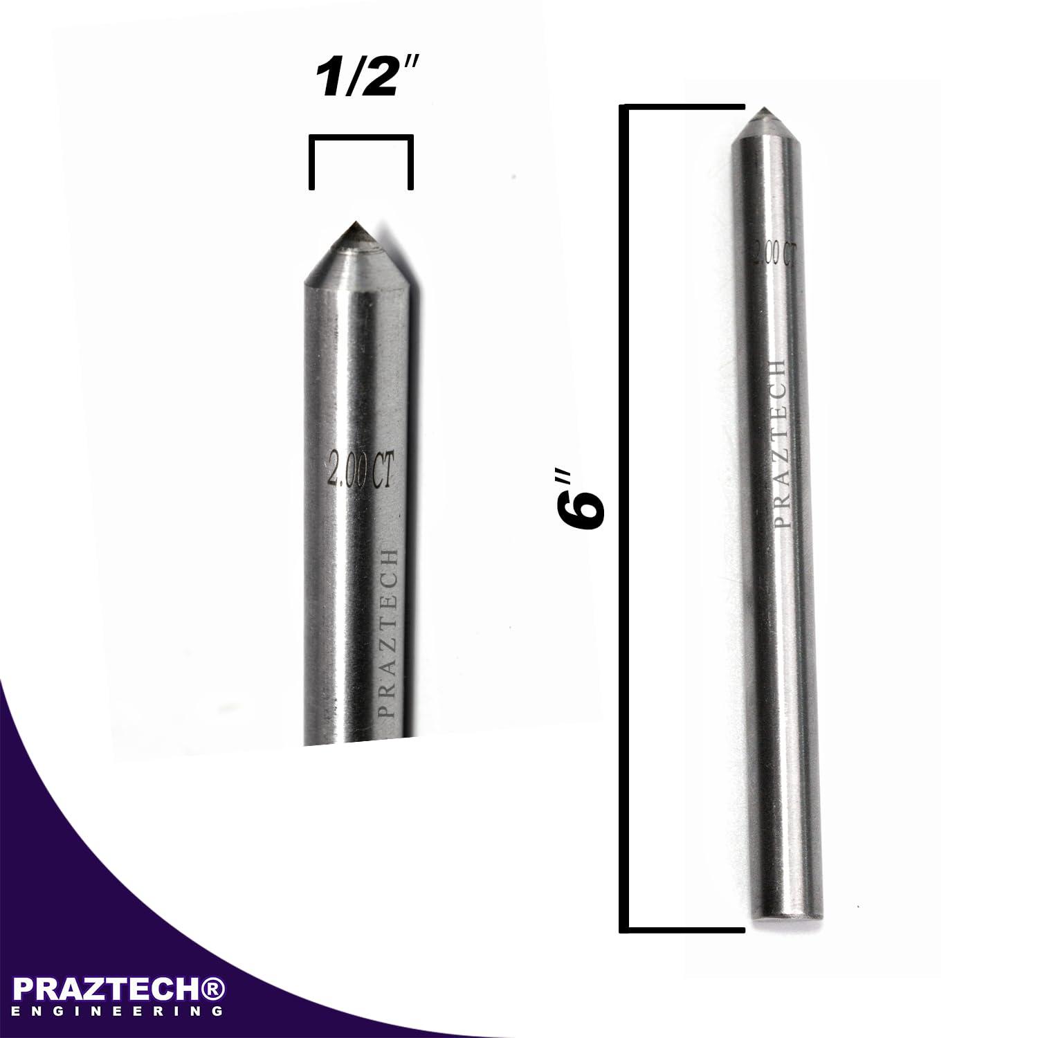

Yes there is. I gave up trying to use the revolving type years ago and now use a diamond tipped dressing tool. This picture is one I found on Amazon which looks a bit like mine. They work a lot better and way quicker so be careful not to go in to hard with it.
