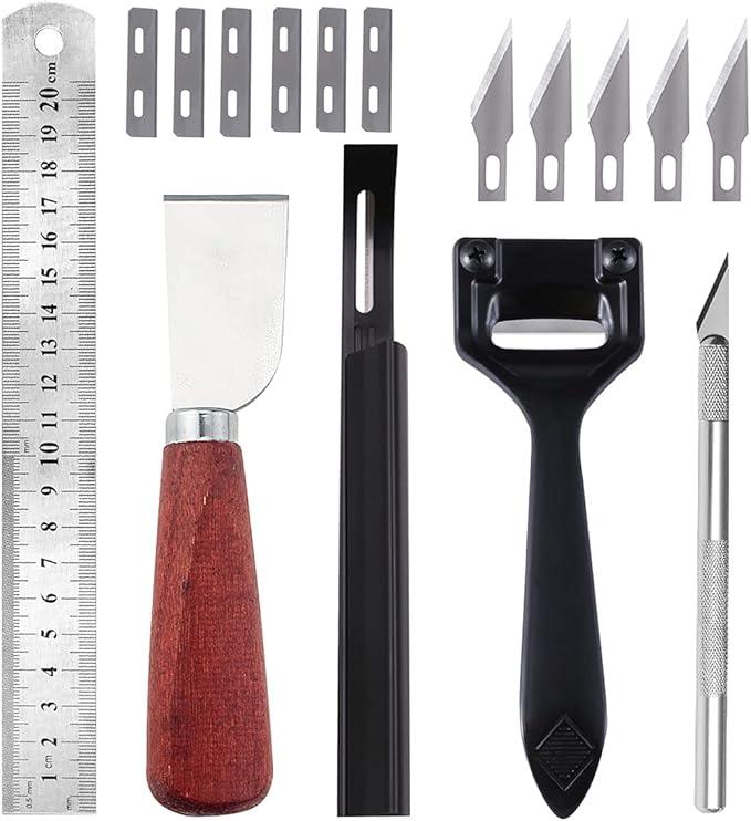

I have the first one and haven't had good results...it scraps instead of cutting. I assume the blade was sharp when I bought it. I have replacement blades. I have something that looks a lot like the second one, but it is different. Maybe I have a bad knock off of a better design? The third one is considered a French skiver? I thought that type was for thinning out the surfaces of leather...I didn't know if was for edges. My whole life I've lived by pushing blades away from me, so the French design might be better for me. The two razor blade models in the picture are pulling toward me which is awkward. So far, I've had my best luck with the wood handled knife that came in this value pack, but it's such an uncomfortable, unpleasant experience:

I presume you have one of these; Get one of these; Get a couple of these; for tidy skiving of edges I have several in 6mm, 8mm and 10mm widths Avoid this like the plague, sold as a 'skiver'. You'll waste your money

For me, the key was learning to get the knives really sharp with a ~15 deg bevel. I am mainly skiving veg tanned leathers. I place the leather on plate glass with a bit of beeswax rubbed on the glass to grip the leather because I am working on small pieces that are difficult to grip while skiving an edge. That cheap Chinese knife from Amazon does a reasonable job when kept sharp. I've been meaning to learn how to use a safety skiver and this Don Gonzales video has some tips. He also notes (in another video?) that the blade should move diagonally along the edge when skiving, not straight down the beveled edge.
