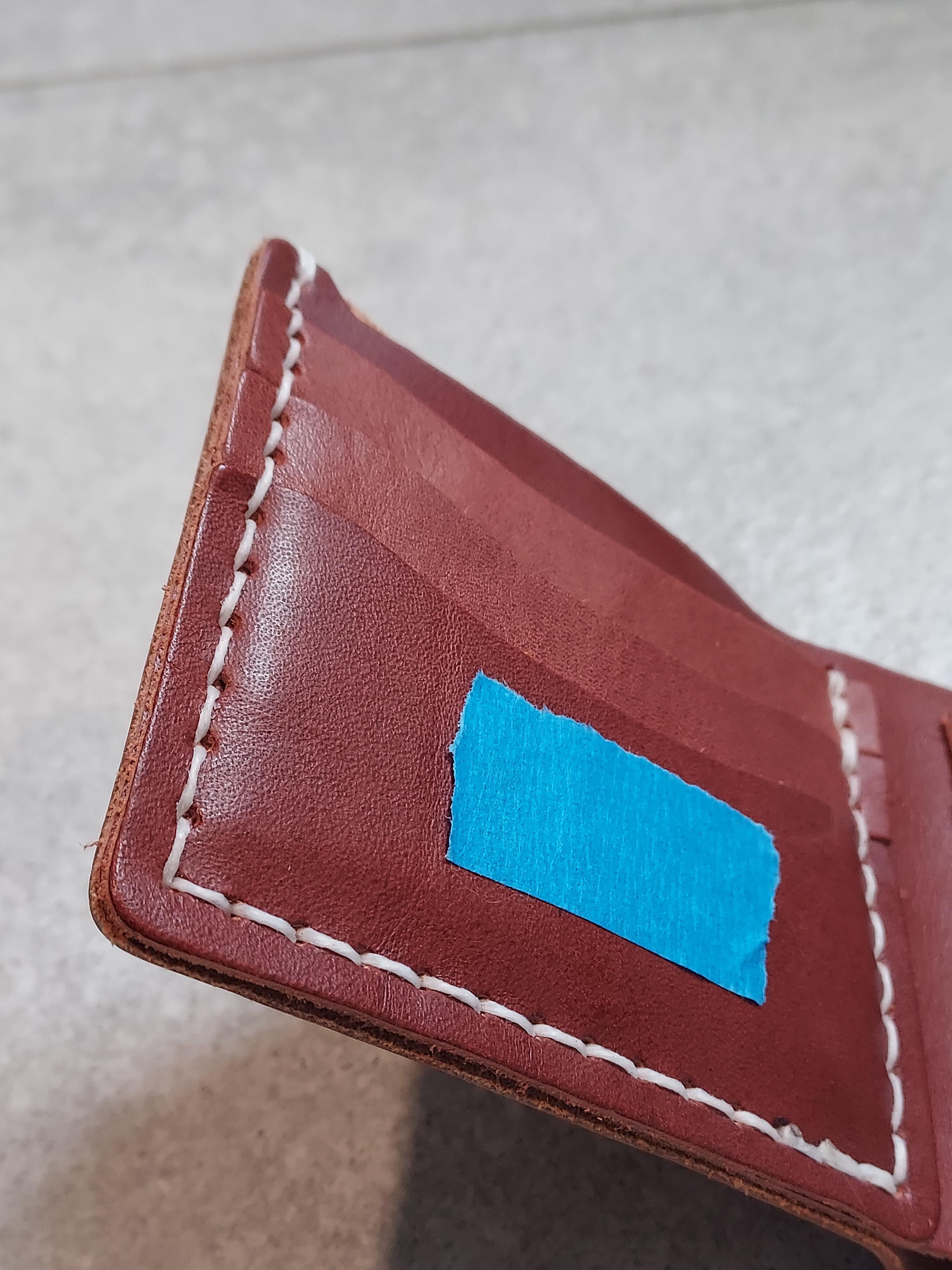

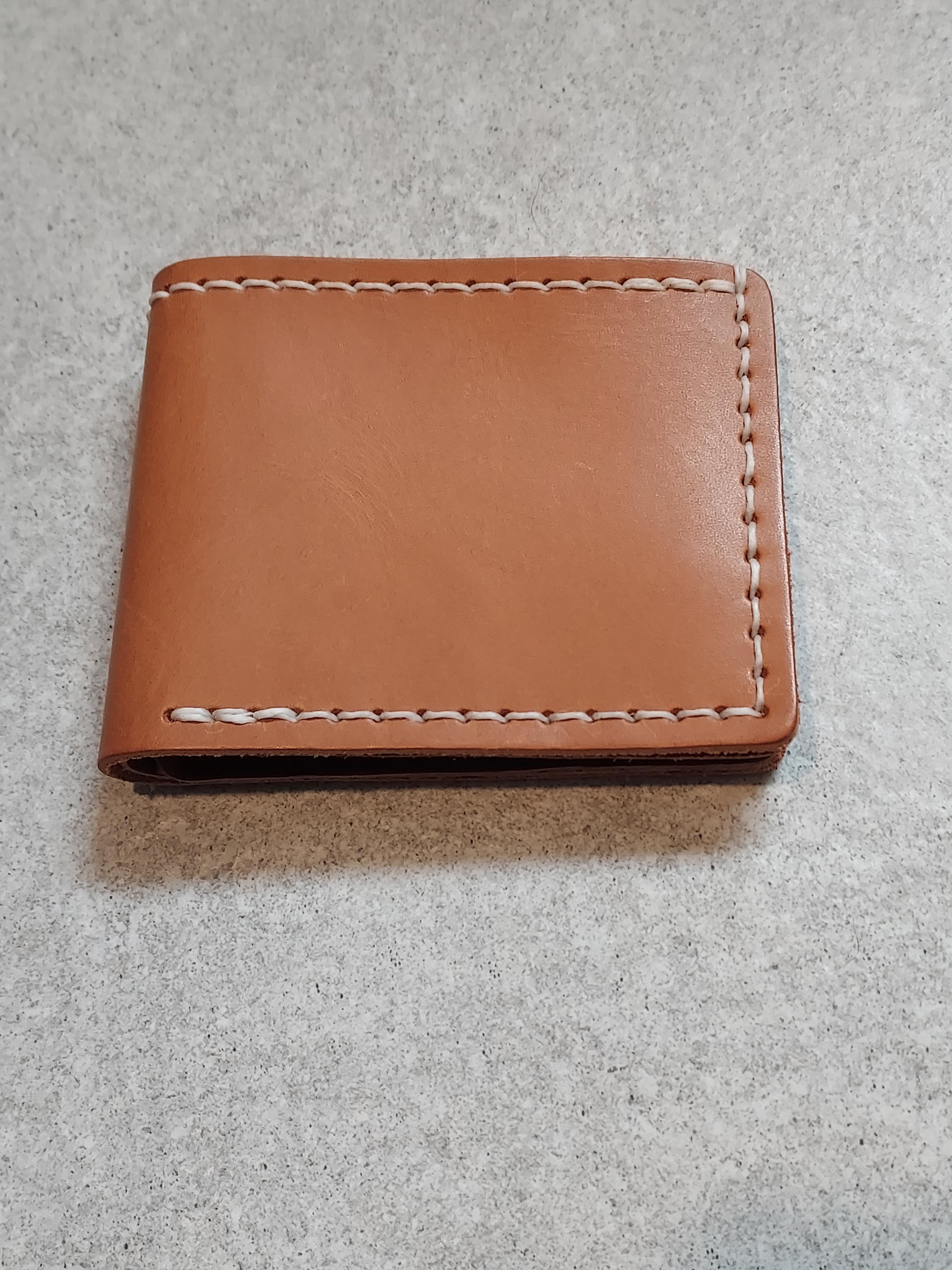

Well, things I would do differently; 1. looks like the sewing was through punched out round holes; I would use a diamond hole, punched thru but not out 2. Stitching is heavier than need to be; I'd use a much lighter/thinner thread 3. the stitches lay on top of the leather; I'd have a groove cut or run for the stitches to lay into 4. I don't like the way the stitching goes over the edge at the top 5. I'd prefer a brown thread rather than a stark white 6. no edge finish at all. I'd slick and burnish that edge
Full disclosure: I have not sewn a stitch or cut a single piece of leather. But I'm definitely curious and looking to find a way in to the craft. I recently bought this wallet from a well known crafter. I hid the mark, I don't want to malign or criticize or disparage anyone in any way. But I was a little disappointed. I did not pay the full ~$100 retail price which is common. If I had I would have been very disappointed. To be fair, I bought it as a grab bag/mystery sale item. I don't see any obvious flaws, so I don't know why it got sent from the retail shelf to the grab bag bin. But since it does have the maker's mark on it I take it to mean it was approved to be sent out into the world. Questions: 1) Is the level of finish typical of a $100 product? 2) Or should I assume, since it was a grab bag item, that there is some flaw I am not trained to see? 3) I was thinking of using it as a practice piece. Can I skive it? Sand and burnish it to look pro? Thanks!

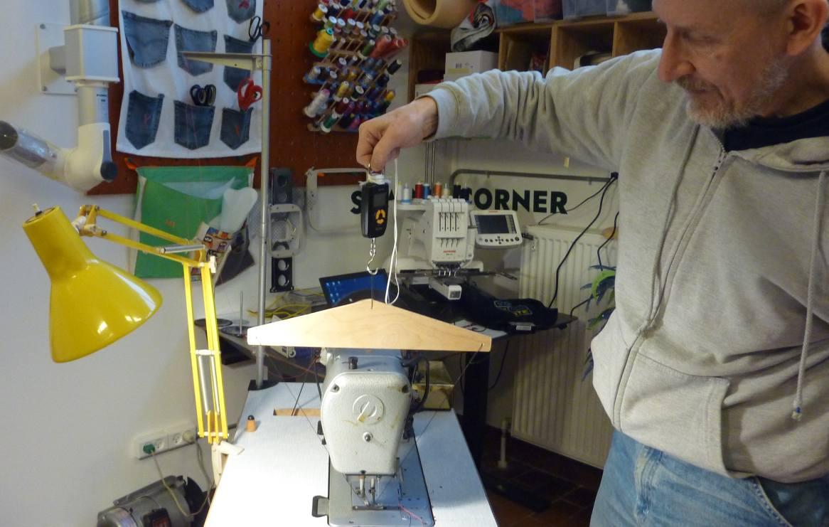

Well, already my post from above is 4 years old. At the moment I do some test on a Dürkopp 291 industrial combined feet sewing machine. I have tried to measure the presser foot pressure and on its minimum setting, it provides a pressure of 87 N (8,9 kg or 20 lb). Maximum is 220 N. To me this pressure seems very (and too) high. But the machine works fine on tarpauline. The picture below show how it is measured. I have tried to look up in specifications and service manuals regarding this and other similar sewing machines and have not been able to find data. So I hope, that you perhaps have seen that. AI answer that this pressure is 5 to 30+ Newton on industrial sewing machines. I found one newer Janome HD9 household sewing machine, with a specification up to 11 lb (5 kg or 50 N): https://www.janome.com/product/hd9-professional/#machinespecifications I hope that someone else might have seen this pressure specified on another sewing machine or perhaps have measured it.
