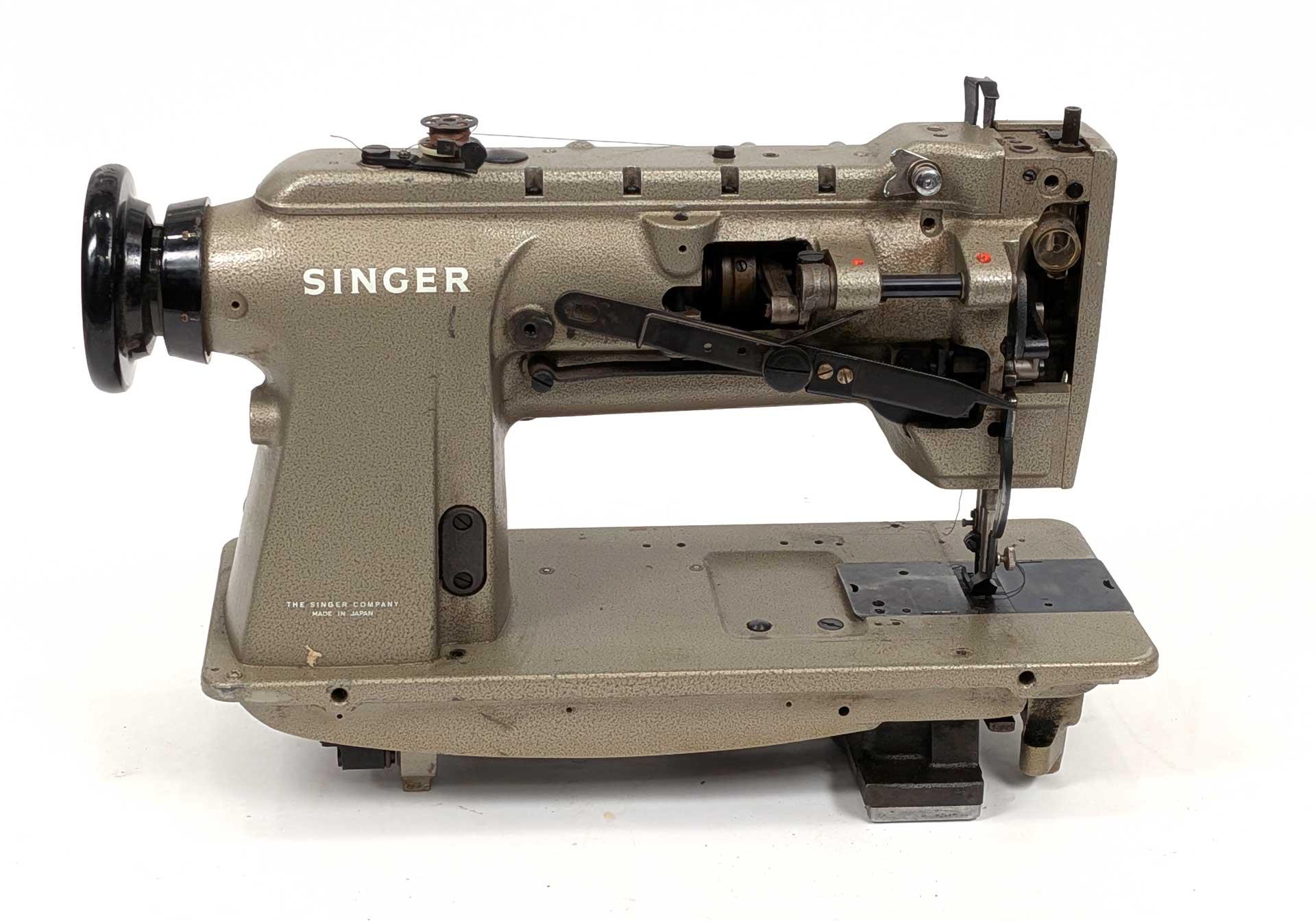

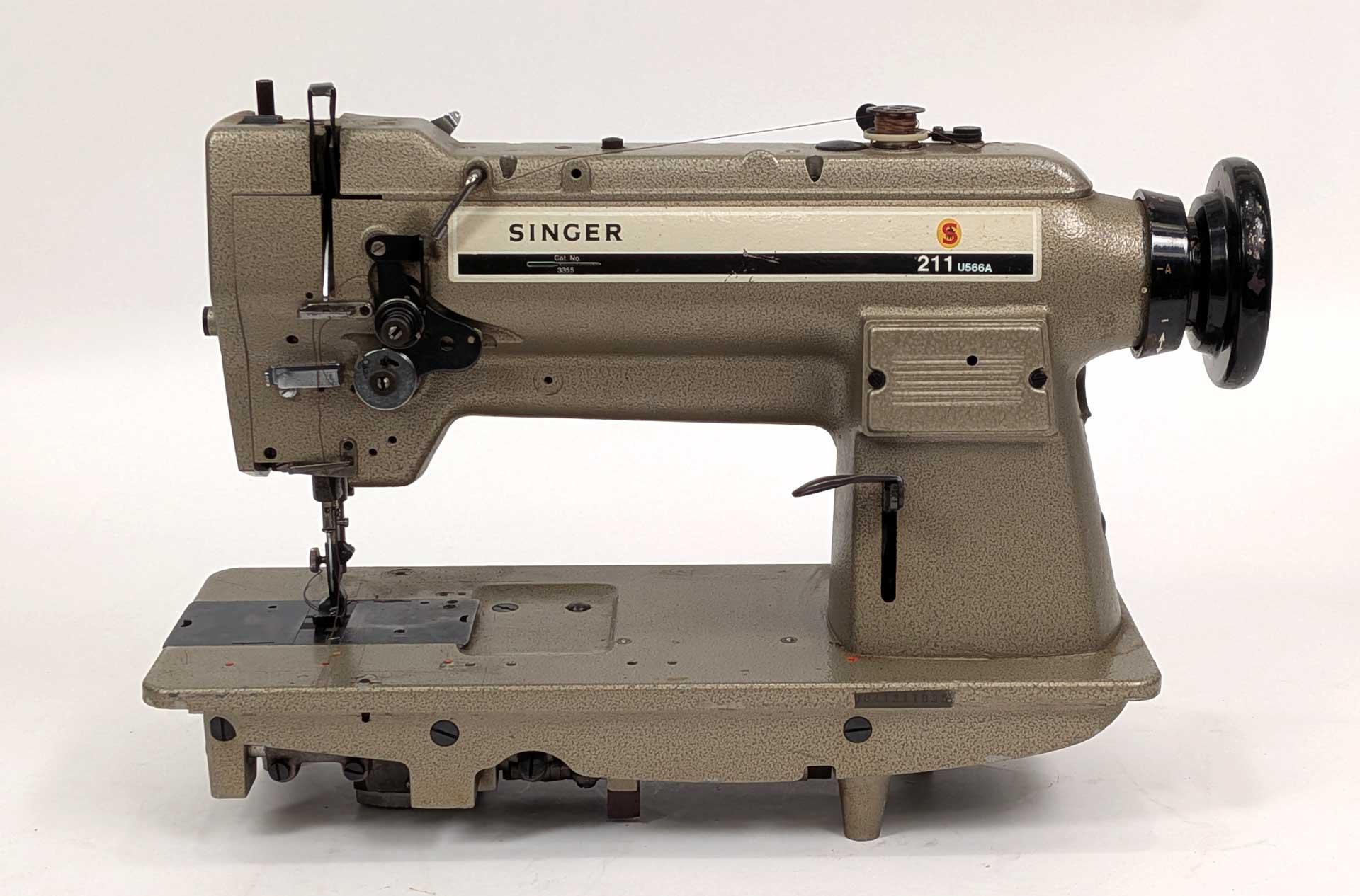

Nicest condition 211 I have ever seen. Professional walking foot Singer excellent for thick leather, webbing, upholstery. 1/2" foot lift. Lightly used: Movements and stitches are smooth and beautiful. A few light paint scratches but none of the paint is worn off from the heavy use that most of these units have seen by now. Asking $1000 Can be crated and shipped or personally delivered depending on your location. pm me here or email solowiejs@gmail.com
