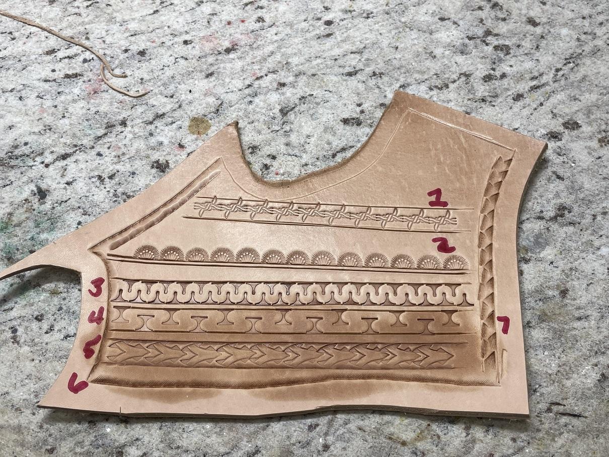

Fender repair...
BlackDragon replied to Brokenolmarine's topic in Saddle Identification, Restoration & Repair
Best way I've found to straighten leather when it comes in to the shop is to dampen it a little and letting it lay flat. You can cut it while it's slightly damp, the knife will go through it easier too. It's not going to hurt the leather just like when you case it for tooling. I like the tooling options 2, 5, and 7 and would be happy with which ever matched my saddle the closest. -

Fender repair...
Brokenolmarine replied to Brokenolmarine's topic in Saddle Identification, Restoration & Repair
Went out yesterday evening and did some touch up to the cutting, reducing the size of the small pieces, cutting them down to match the original pieces. They were both oversize by about 1/8" all the way around. Got that done, then took a piece of the same 15 ounce leather, and started tooling some border tests, rough test borders. Now these are rough, I didn't take my time and perfectly space or match the tooling as I would when I actually did the pattern on the fenders, but it would give the girls the idea of what the border would look like. Then I took a pic and sent it to my daughter to share with her friend, and took the sample in to the wife. #7 is a rope border and didn't turn out that well. The spacing of the lines was off, and I didn't work hard enough to get the placement of the tool correct. I have done much better in the past. That's on me... Might have looked a lot better if I had taken more time. "I" personally have always liked the two serpentine patterns, although they are a lot of work. (#3 and #4) Miss T voted for the double line and shell (#2) Jess liked the Barbed Wire (#1) knowing I would open up the lines a bit to center the string of wire. But her friend agreed with Miss T, voting for the simpler / thinner pattern represented by #2. Fine by me.... a lot less work. I'll go out this morning and dress up the edges of the fenders, then decide on the layout for the borders and cut a cardboard template to insure the lines are consistent. Pencil in the line, then CAREFULLY cut in the border line with the swivel knife, and tool the pattern on both fenders. Might take two or three sessions. -
