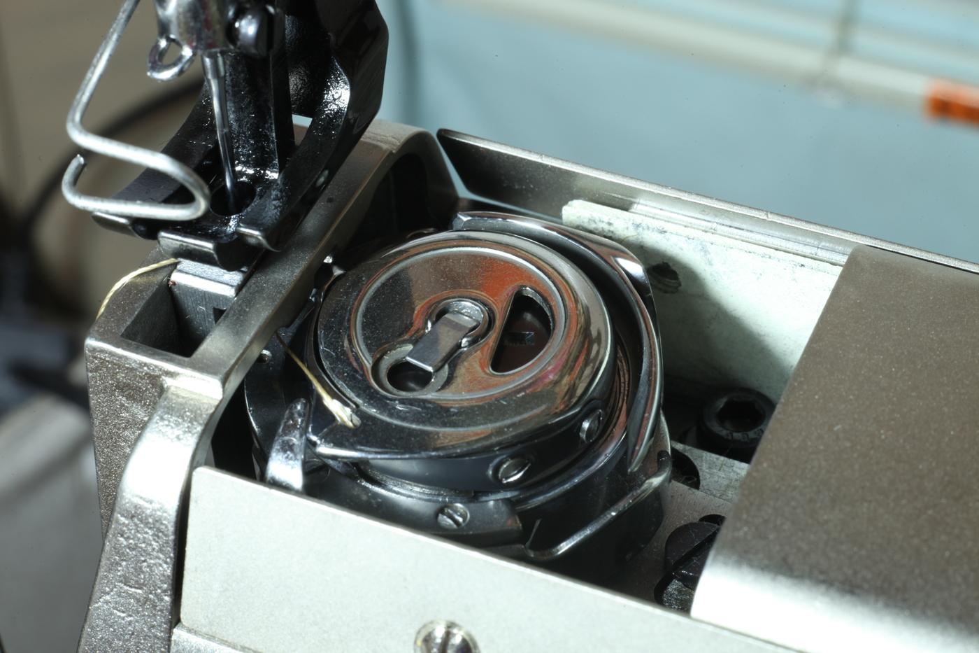

  2. Checked tonight for a second spot to attach the return spring. I don't see one. I did try turning the attachment point around, which almost works but then one of the levers bumps into it when you select long reverse stitches. I'd like to replace the factory spring with one that has less stiffness, but I haven't been to a hardware store in a while. Maybe it's time to start forming my own springs.. It only engageswhen I want to wind a bobbin. I wrote that part a couple months ago, and it actually hasn't bothered me since šŸ˜€ And I actually use the winder more than I used to. That is, when I think of it and when I think I might be using the same color bobbin thread for a while. I switch colors a lot.. I looked at this tonight. I don't see a good option outside of making my own label for the knob. Or drilling a new hold for the pin that acts as the final stop for the knob. I'm setting it so that the stitch length goes to zero as the pin runs into the final stop. I suppose instead I could figure out where a 4mm stitch is and line the knob up at the 4. šŸ¤” Ok. Seems reliable with a round eyelet. I can see benefits both ways. Here is the hook assembly. I assume this is NOT the singer 111 style. I wonder if the singer style has a larger outer hook diameter..

  16. Most machines have two spots to hook the return spring into. You should check to see if yours has a second location to give a softer return. Possible solutions: a. The internal rubber wheel that drives the winder needs to be adjusted so it only engages when you want to wind a bobbin. However if you wind a bobbin while sewing it can create a problem of unwinding the thread from the bobbin. There seems to be a couple of versions of this model some with the bobbin winder on the top of the machine and others driven with the main belt. I would just cut to the chase and buy a winder that runs of the main belt which probably would cost about $16 USD off Amazon. The dial should have a set set so you could move the dial to the correct position. Most machines are that way. I know some of those machines came with a smaller top thread pin with only two holes. As a note the hook assembly in the Jianglong 341 seems to come in couple of favours one that looks like the old old Nakajima 341L which was similar to the Singer 111 and another that is like the Juki LS-341. Which one do you have??? Just my thoughts. kgg Juki bought Nakajima and renamed it the Juki LS-341.
