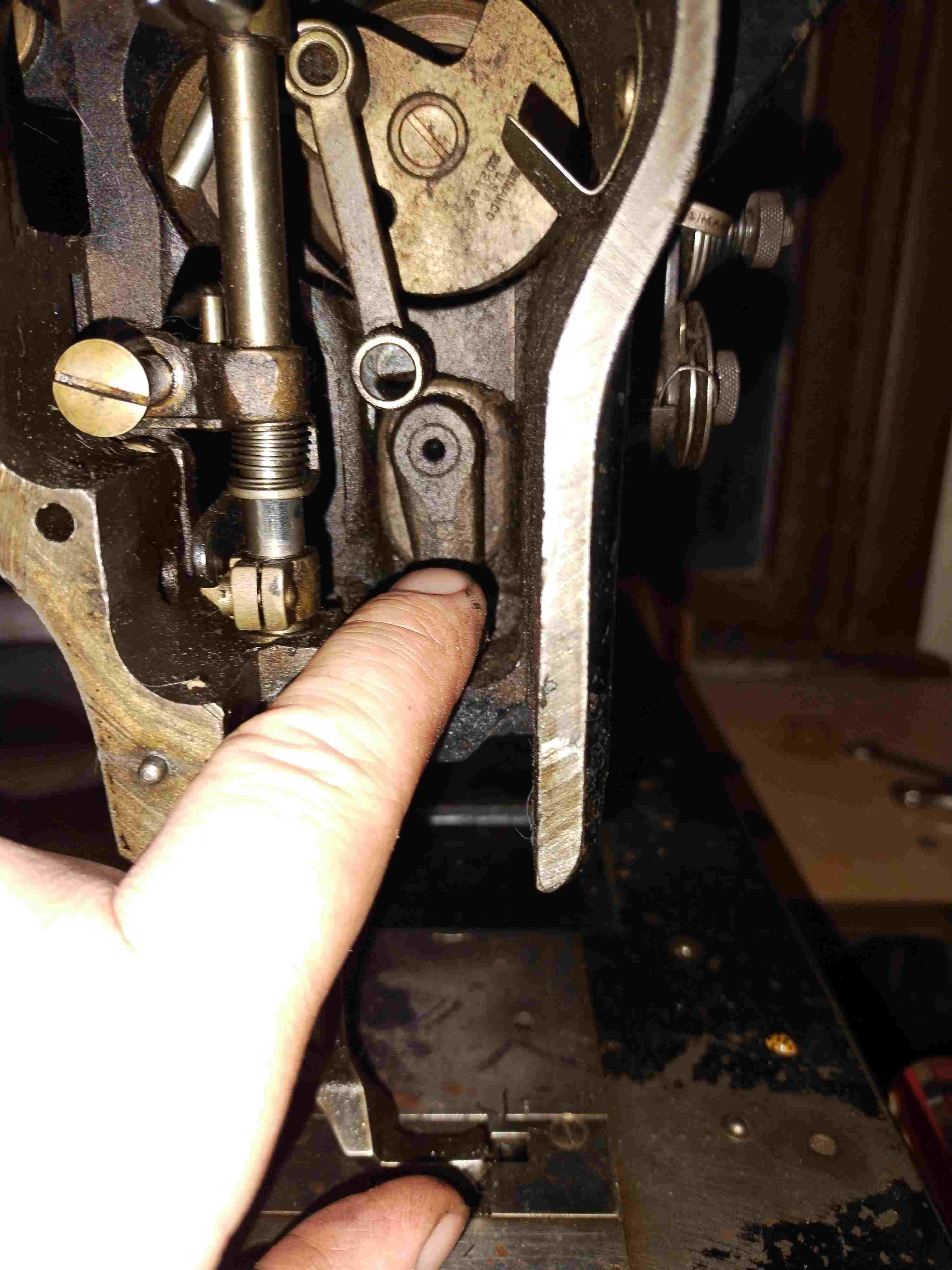

I did watch the video. I had to go look at my 153. I found the clamp in the attached pic that looks like it would affect the position of the needle bar. Haven't a clue. Yet. EDIT: The part number is Simanco 202666 and comes back as "Rock Frame Position Bracket". Do we have a winner?

Is the handwheel easy to turn? Have you oiled the machine? (Do add some oil if not) Does the needle bar move front to back if you push it with your hands? You will need to find the clamp that Wyowally references and verify that it is indeed moving the "needle bar rock frame rock shaft" as singer calls it. We are looking for the clamp at the far right end of that shaft. If the clamp is loose, tighten it. Make sure the clamp and the rock shaft both move together when you turn the handwheel. If neither the shaft nor the clamp move when you turn the handwheel, flip the machine on its back and inspect the parts underneath that drive that clamp. If the shaft does move but still no movement at the needle bar, take the left end cover off the machine and find the crank arm at the left end of that shaft. Here's a photo of my singer 144W103 with the needle bar rock frame removed, and the yellow arrow points to the crank arm you want to check for movement.

Thank you! I've removed covers and have attempted to find something out of the ordinary. Were you able to watch the video I posted about the issue? Looking forward to hearing what you find. Dan
I have a couple of this class machine but haven't run into this problem. Forgive me if you've done this, but it seems like popping that cover off and turning it by hand should yield some kind of clue. Just observing and following the mechanism back. I poked around a bit and couldn't find any videos on adjusting the needle bar position other than height. Tomorrow if it's warm in the craft room I'll look at mine and see if anything jumps out at me. Now I'm curious, too.

Thank you for the response! Much appreciated! This machine has been pretty much trouble free in my lifetime. Were you able to watch the video? I downloaded and printed the military manual and some illustrations were scrambled. Lubrication drying out? Does the needle bar get moved by a cam? Gets pushed on way and spring return? I'm attempting to wrap my head around how dried lubrication can cause the needle bar to act this way. Dan
