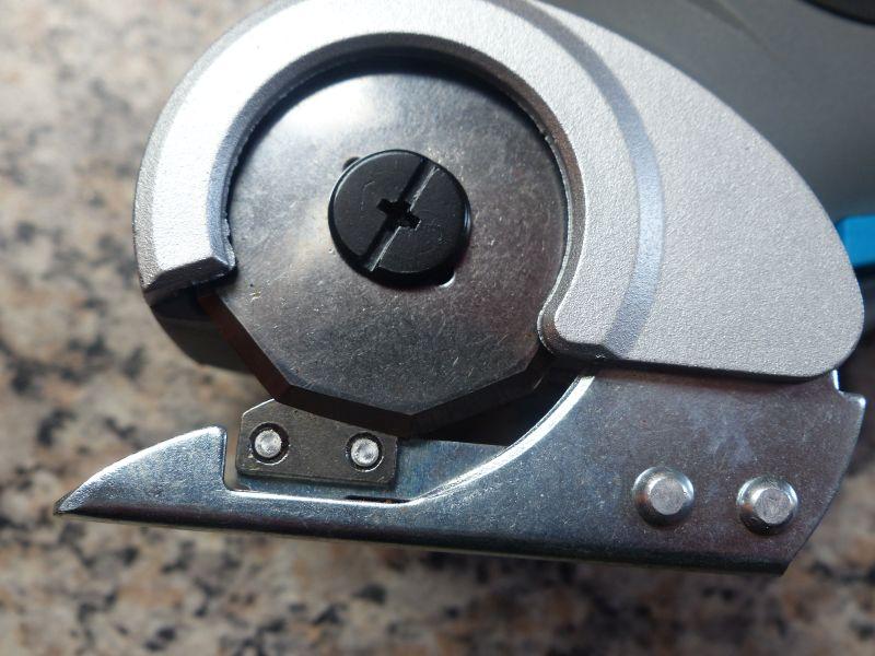

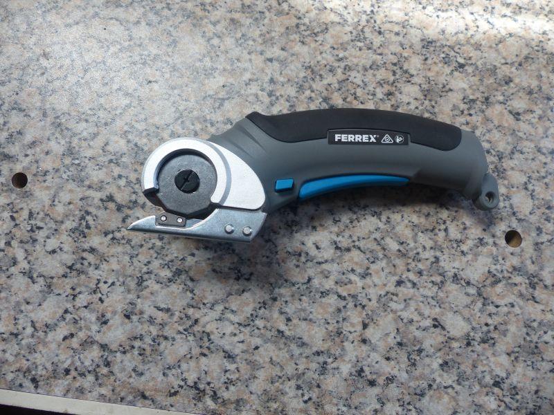

I saw this little thingy at Aldi and for $15 just had to buy one. Rechargeable rotary cutter, says it can cut up to 1/4". I tried it on a piece of old saddle skirt, 1/4" thick and quite hard, and it cut it nicely. The blade is interesting as rather than being round it is octagonal so has sharpened "points". Could be useful for softer leathers.
