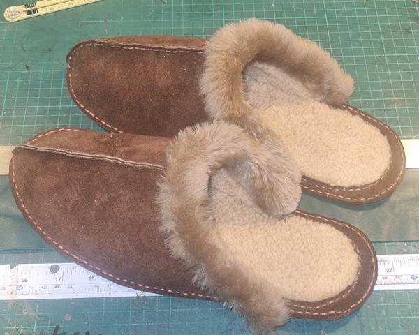

Good job Chuck, I did much the same thing. Got half way through and got fed up trying to work things out so bought a pattern. Easy enough to do and I had a piece of sheepskin. I ran out of sheepskin so used a bit if something else. I have lots of real fur that's just sitting there cos many over here are squeamish about real fur. Turns out I don't like the open back so will prolly put a back on. I'm not keen on the boot type but they look good. I do like the blue ones for something you can go out in in fact, when I bought the slipper pattern I bought this one also which is closer to what I was trying to do in the first place.

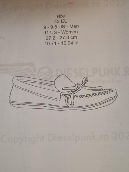

Well you've already bought the kit now which will serve for a while. As you're finding out, a question like this has a multitude of answers. They all mean well and as in all things, everyone has their own take. I'll just add this. Start with a pattern! Everything will be explained in detail, you'll understand each step and why and will give you confidence to look for the next project. Many pattern sellers provide a step by step video and tell you what leather and how much you'll need. This was my very first project (I'd done some reading of course). It's a Dieselpunkro pattern (Motoko3) and I made it with the minimum of tools. I have no affiliation with Dieselpunkro but from recollection I know he has some mask patterns.
