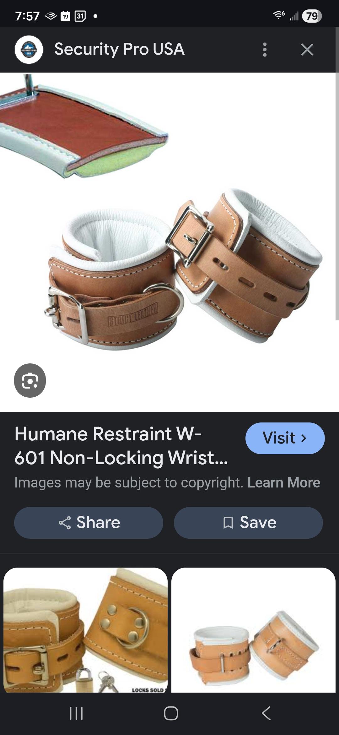

Ive just started making some ankle/wrist cuffs restraints. I see different types of buckles being used and im wondering if there is any consensus on what the best buckle for these would be? Im thinking somthing somewhat rounded for comfort and safety and center bar so dont have to add a keeper loop. Any ideas and suggestions greatly appreciated. Pics added just for examples
