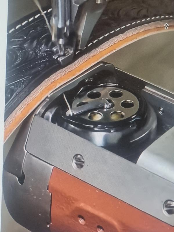

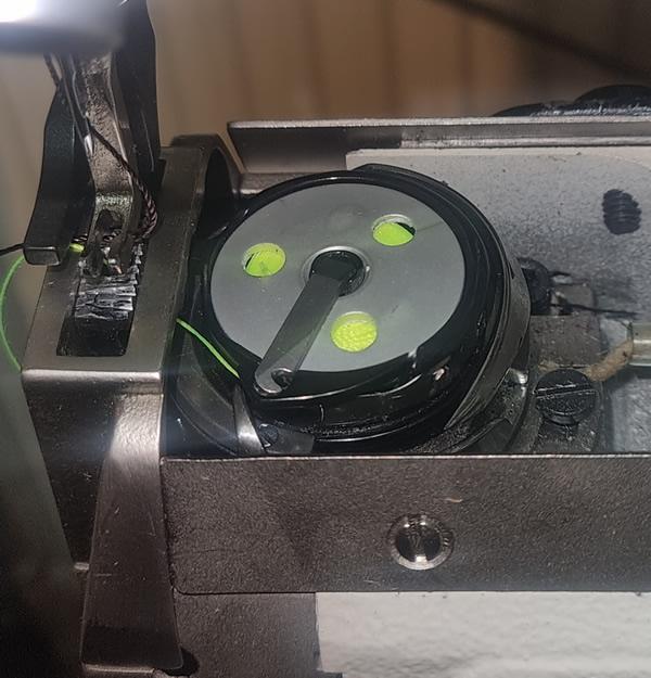

  7. Yes but I don't see a slot on the Cobra. It's where it goes after the tension spring that's got me puzzled? There's no way my thread can double back after coming out of the tension spring and go through the little notch on the bobbin retainer on the top like it is on the Cobra.
  8. Yep. The bobbin thread runs through a slot/notch and under the tension spring on the bobbin case. EDIT: I'm not sure what machine you have but when you drop the bobbin in, there will be an angled slot somewhere in the case. The bobbin thread will go into that slot *in the same direction that the slot is angled up*. That notch you refer to should be the top end of the slot. Pull the bobbin thread up and out that notch. The bobbin thread then changes direction and passes under the spring. Every machine I have operates this way.

  13. Saw this on a video short. Guessing it's a Cobra and noticed the thread going through the notch in the thingy that holds the bobbin in place. Is this standard because I don't see any way I could do that on my machine? Of course i could always be missing something.
