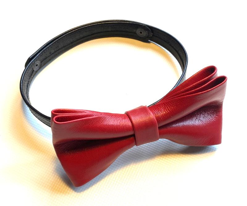

Yesterday I joined the Ghent edition of the Distinguished Gentleman's Ride and for the occasion I wanted to dress up a bit, so the day before a made myself a bow tie. Red sheepskin for the bow and black cow for the collar, both chrome tan. Edges skived and folded over and the collar received an edge stitching all around. Closure with two black 9mm s-type snaps.

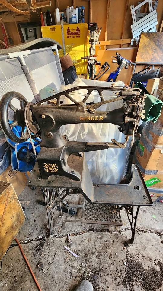

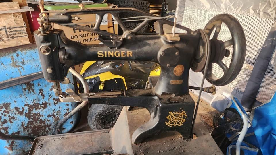

I just bought a beautiful Singer 29K-70 with treadle base. I got it from the grand-daughter of the original owner. Looking forward to cleaning it up and a fresh lube job. It is in extremely nice condition, looks like everything is there. even the original leather belt, still on it.
