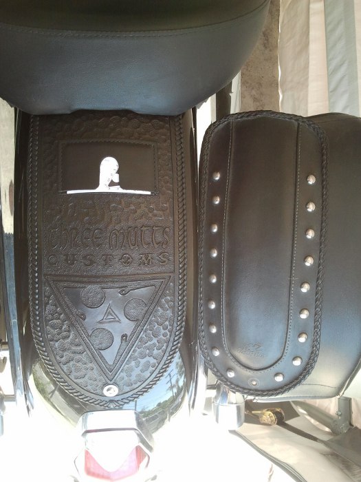

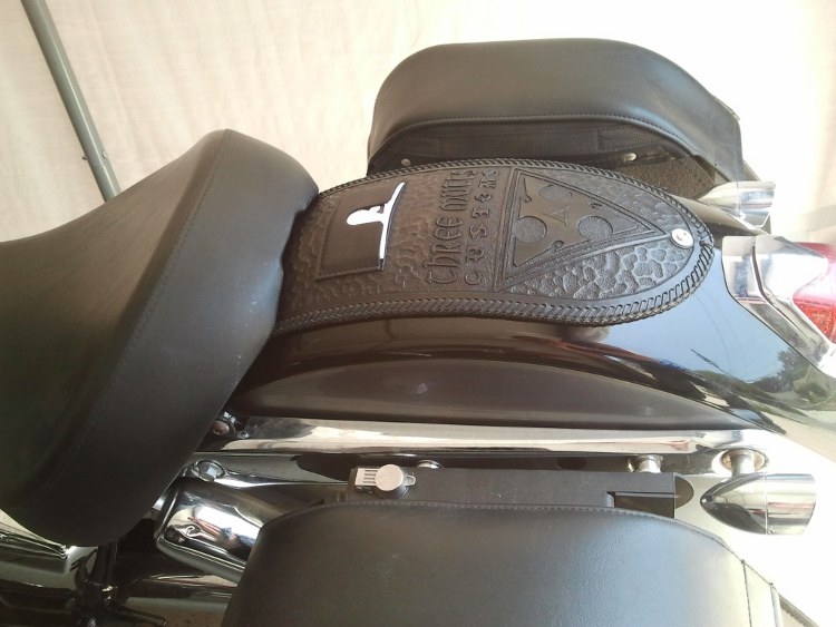

This was a bag I did the prototype for last summer. I got busy and never ended up making a production version. Interestingly enough, a fellow rider saw the bag discussed on my blog and asked if I would finish the design and make him a real one. I custom make the brackets out of brass and paint them as well as shown in one of the pictures. 9oz. back panel for stability, 4oz front to do the wetforming and a 6oz. flap to give it a solid look & feel. Triple loop lacing in kangaroo for the edges (I'm very happy with how the lacing turned out, even around the odd corners). Finished the patterns (and converted them along with the wet forming blank to left side mount) and then cut, dyed, laced and etc. the whole thing in two evenings. Gotta love it when a project is inspiring enough to crank it out. Now I just need to make a set for my bike with some tooling on them! The first two pictures are the photos the client saw of the prototype that spurred his request. I'd say the one he's getting looks just a touch nicer. Chris
Finished a pair of whaletail tank bibs for two Honda VTX1300s this weekend (two different clients, same bikes). The first one asked for the POW-MIA tooling and a pocket to hold an iPod & notepad and then asked for the Airborne wings to be added somewhere. The color & royal blue lacing he added on and ended up looking kind of cool (his bike is also painted blue). The second one is a whaletail bib with a double row of 1/4" buckstitching running down like racing stripes. Both were made with W & C 6oz, wet formed to the tank. Kangaroo for all the lacing. Golden Fluid acrylics (white & irridescent silver) were used for the colors. Both have triple loop laced edges and felt on the undersides to protect the bike's paint. On the pocket, I tried something new and did an expandable folded pocket like was shown in the LW&SJ two issues ago. I used 3oz goatskin for the pocket front, veg-tan for the flap and to get a bit more room out of it, I welted the pocket with two 6oz. 1/4" wide welts all around. Kept the pocket fairly flat while providing an extra 3/8" thickness without the pocket expanding. Chris
