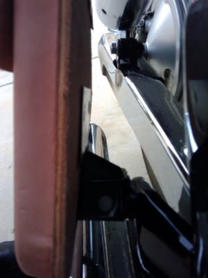

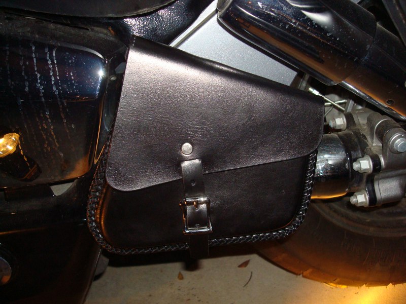

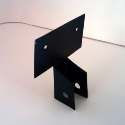

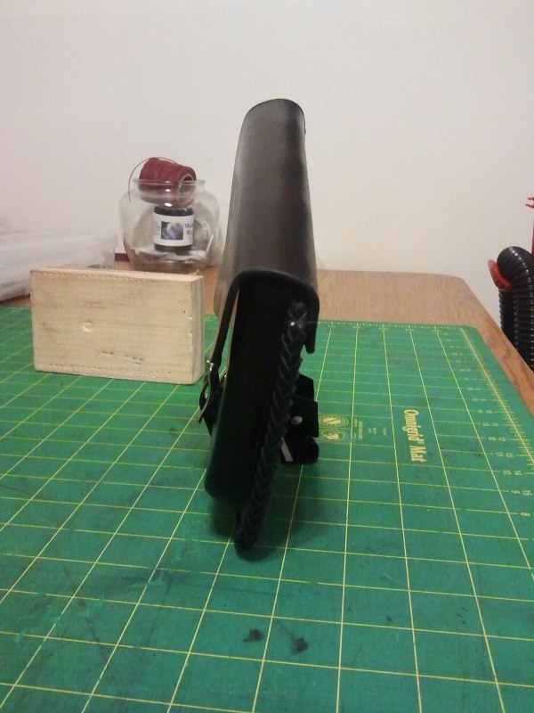

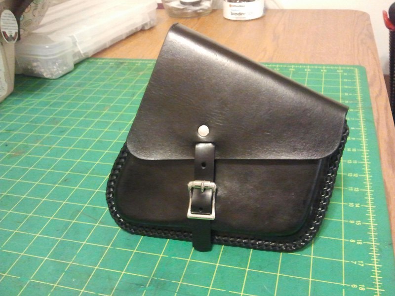

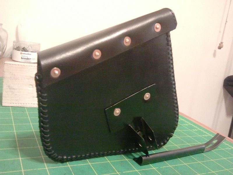

Hey Winterbear, I sell them for $80 (about half the price of a full size solo bag since they are half the size) plus shipping. The bracket is only guaranteed to fit the Honda Aero and Spirit 750 models though as the foot pegs can be different on various bikes. What I can do though is to punch the holes for a bracket if he has a different bike and then he can make or get a bracket for his bike and then use chicago screws to secure the bag to bracket. Hey Aaron, thanks for that info. I tried two shops already and they didn't want to do it. I have cut granite before with my die grinder but this is a bit thicker and a longer line than that so I'm not sure I'm in the mood just yet to try. Chris
