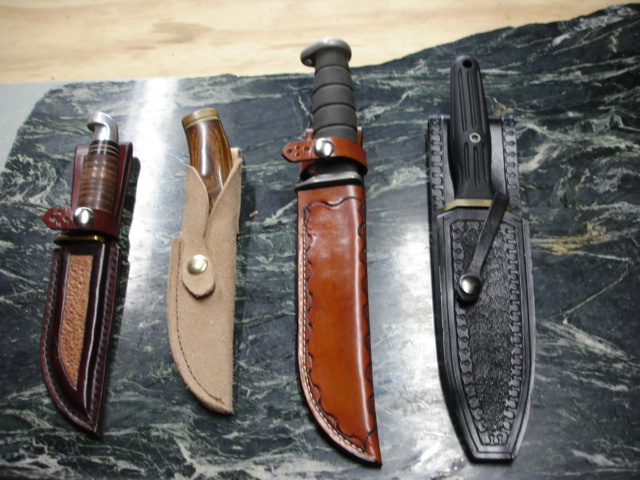

Knife Sheathes Off The Bench Today.
GrampaJoel replied to GrampaJoel's topic in Gun Holsters, Rifle Slings and Knife Sheathes
Thank you. -
I think it looks great! That's a lot of edge to color though.
