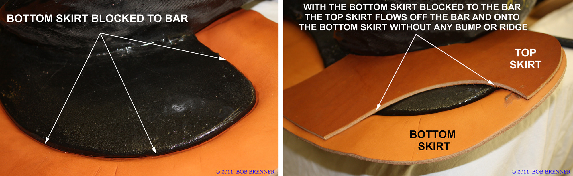

Need Help , Quick Question On Stirrup Leathers / Fenders
BOB BRENNER replied to SethJ's topic in Saddle Construction
If I understand your question correctly from the picture, you are concerned about the stirrup leather and fender being flat against each other when assembled. There is a step or sequence that is required that I have never seen addressed in the various books or videos I have looked at. Once the stirrup leather is attached to the neck or tail of the fender, you must turn back both the neck of the fender and stirrup leather making sure that the neck of the fender and the stirrup leather are tight against each other as it would be to accept the stirrup before attaching the stirrup leather to the top of the fender. If you attach the fender and stirrup leather flat and without this bend you will get a bubble in the stirrup leather. Also, if you are going to lace the stirrup leathers, the neck of the fender needs to be 16" to 18" long and the area for lacing holes needs to be around 8" to 10". You can glue and stitch this area, but I would not glue and stitch the entire neck of the fender. Good luck, Bob -

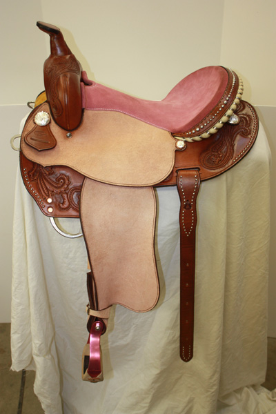

Aurelie, Have build a few barrel saddles, so here is a very short course. Currently the most popular style of a barrel saddle is one with round Mother Hubbard style skirts with in-skirt rigging. Typically, the horn will be thin and around 3" to 3 ½ " high with a cap less than 1 ½". The swell will have little froward tilt, about 3" thick and 12 to13 inches wide. The cantle will be 4 plus inches high. To reduce bulk the fenders will be down sized and 2 ½" half stirrup leathers are used. Weight is a consideration so lighter weight skirting leather is used. The treeless saddle has become popular of late along with smaller skirts on regular saddles. You had a question as to fitting the Mother Hubbard style skirts. Mother Hubbard skirts have a bottom skirt and a top skirt. See the example of the skirt pattern I have used for several years. All skirts need to be blocked no matter what type of saddle being built. One can get a bump or ridge plus some other problems when a rear jockey is used and the skirts are not blocked properly. A tree with thick or beefy bars will make the blocking process harder. A saddle with a rear jockey is a little forgiving because the flow line is broken up by the edge of the rear jockey. The bottom skirt must be blocked or molded to the point where the skirt is on the same plain as the top of the bar. Any unevenness will be transmitted to the top skirt as a bump or ridge. Once the bottom skirts are blocked or molded to the point where the bottom skirt is on the same plane as the top of the bar, the top skirt will flow onto the bottom skirt with not bump or ridge other than the curve of the bar. As far as I know there are no books or videos on barrel saddles. The construction techniques for a barrel saddle are the same as any other saddle just a different style as stated before. Study the internet for examples. Hope this helps you, Bob
