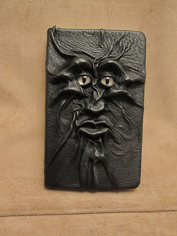

  21. I saw some of these at the Ren-Fair here in Atlanta. The leather felt like upholstery leather. Soft, and a bit pliable. I assumed it was glued together. I actually introduced myself and tried to discuss the technique (I have no shame ), but I really am not interested in make these for sale. Too many other irons in the fire. But the gal at the booth said she was just an employee and had no idea of how they were made. But I do like the white leather glue idea. It "feels" right. It stays flexible, yet will hold the leather together. I'd use the plastic clips they sell to hold cloth together for sewing the seams. Expensive, but nice. About #0 for a box of 50, but with a coupon from JoAnns it drops it can drop in half...
