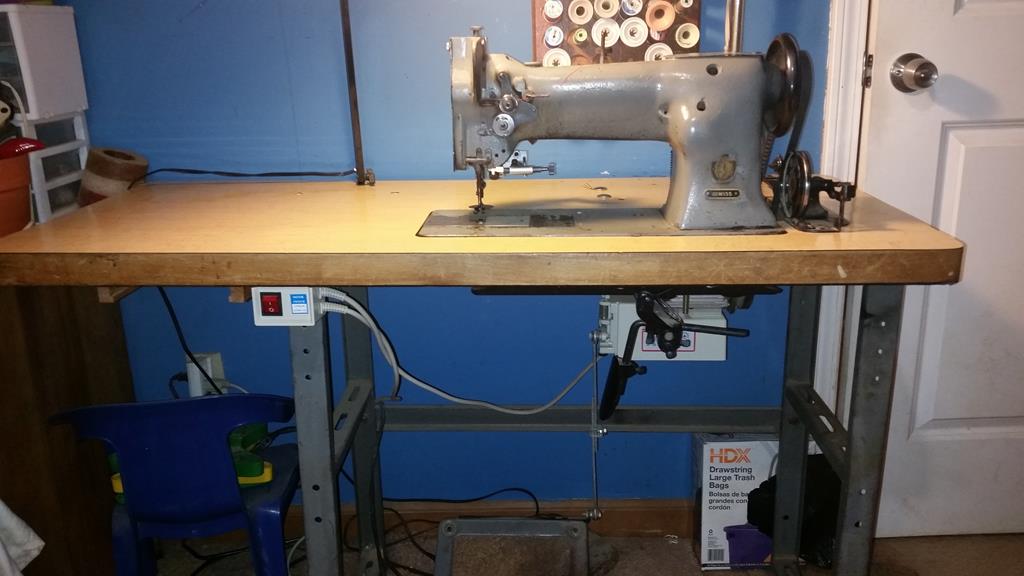

  18. Still learning the new Consew 227R and loving it. Have a question about the "quality" of my bottom stitches. The photos are 2 pieces of 7/8, glued together, 138 nylon thread top and bottom, both fee set to as light a pressure as I can get to avoid marks, but there is no lifting that I can see. Size 22 leather point needle. Longest stitch length the machine can be set for. Is there any way to improve the look of those bottom stitches, or is this just how it is? Thanks
