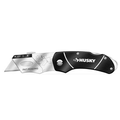

  22. I've been using a heavy duty utility knife for most cuts. I have a couple of head knives but am working on sharpening them (struggling is a better word). I have recently begun using a Stohlman brand curved trim knife for cuts that require curves. I'm finding that I can keep it against the edge of my guide or follow a curved line easier with that curved tip, than the flatter bulkier utility blade. I do need to work on sharpening it as well. I've stropped the fire out of it, but it needs a bit of touchup to be better.
