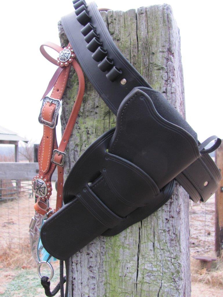

Gun Rig & Bridal
Josh Ashman replied to Josh Ashman's topic in Gun Holsters, Rifle Slings and Knife Sheathes
Thanks Rohn and CR! Yes sir Camano, the bleed know does go through the holster body. I started doing to make sure I didn't get the holster body wanting to pull back through the loops when the pistol is drawn. It didn't happen very often but every once in a while one would move around and bug me. Josh -
It was too cold for playing around with pictures too much this morning so I ended up with these two together. The gun rig is for a SW500 as ordered by a customer and the bridal was a well appreciated birthday present to my better half. JWP hardware and bit on the bridal, leather is 8 oz HO with a 4 oz oil tan lining. The gun rig is 11 oz HO and 4/5 for the bullet loops with black Fiebings pro oil dye and several coats of NF oil and saddle soap. Thanks for looking, Josh
