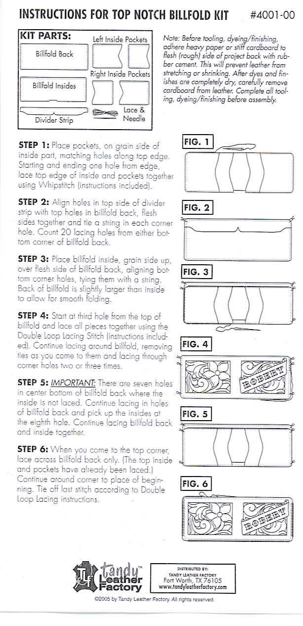

  17. I assembled one a while back. Did you get the instructions?
