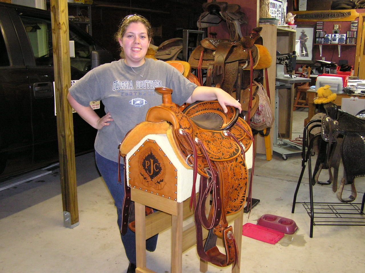

There is a thread in "Show Off!!" under My First Saddle where I posted this photo, but this is the first saddle I ever made. It was my daughter's wedding present in May of 2006.
My first saddle was my daughter's wedding present. I started helping Carlos out in his saddle shop in December of '05, right after I retired, doing some tooling on Christmas presents. After we worked through the backlog, I started doing repair work on saddles. I had already read the Stolhman series and the articles written by Pete Gorrell in the Leather Crafters Journal, but doing repair work was a great education in itself about what worked and what doesn't. In February of '06, Carlos asked me if I didn't want to build that saddle I was talking about for Patty. I said yes, but the wedding is May 20th, is that going to be enough time? He said "plenty of time"... not! We went to saddle week in Sheridan in May and got back one week before the wedding. The skirts weren't sewed, the seat wasn't tooled, the stirrups weren't covered..."plenty of time." Well, I barely made it, but she loved it.
