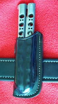

The Bench Made 42S comes with a cheesey nylon case. Its price, I think, demands leather; not crummy cloth.
