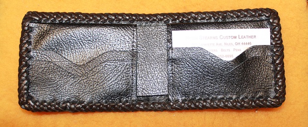

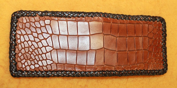

  17. Here is a wallet I just finished. It is made form Diamond Back Croco Print that I purchased from Springfield Leather. The insides were also from Springfield Leather. I glued pigskin liner to the back of the wallet. I am not completely happy with my lacing job. I think I punched my lacing slits a bit to far in from the edge. I like this leather and I like the insides and I'll be making some more with this stuff.

  22. Oldtoolsniper I glue the back lining on the back with Barge cement. Some other contact cement will work also. Then I glue all the edges that are going to be laced or stitched together, with the same. Glue about 1/4 or so in from the edge. Then they are ready for the holes or slits for lacing or sewing. I am making another wallet using Cognac, Diamond Back Croco Print from Springfield Leather. Lacing on it as time permits. It is beautiful leather. I'll post it when I get it finished. Hope you post yours too.
