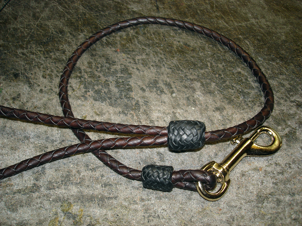

Hello there from NZ Just wanted to show off a braided dog lead with a brass snap hook that I finished this evening. Fully braided in Kangaroo (4 plait) onto a nylon inner and some great looking 13 part 12 bight 2 pass pineapple knots in miniature. Very fidely to do. But I think they look great. Cheers Trevor Way Down Under
