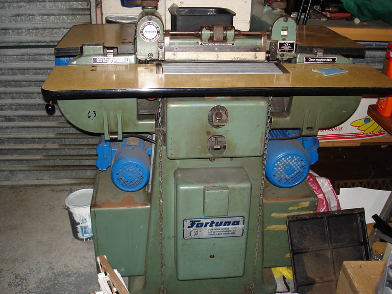

Hey there Ryan About 3 years ago I purchased a Fortuna Bandknife splitter and it is fantastic. I had it converted to single phase but the price was right. I recently had a new knife blade put in and the whole thing serviced and it runs like a dream. I have the steel top feed roller fitted and it will split veg leather easily. It has a 12 inch throat which is a little small sometimes but I get by and I wouldnt be without one now. Cheers and good luck Trevor "way down under"
