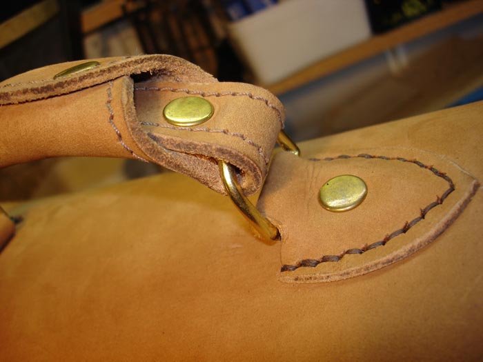

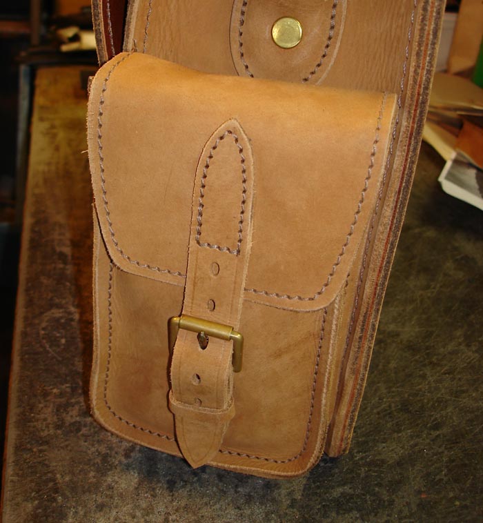

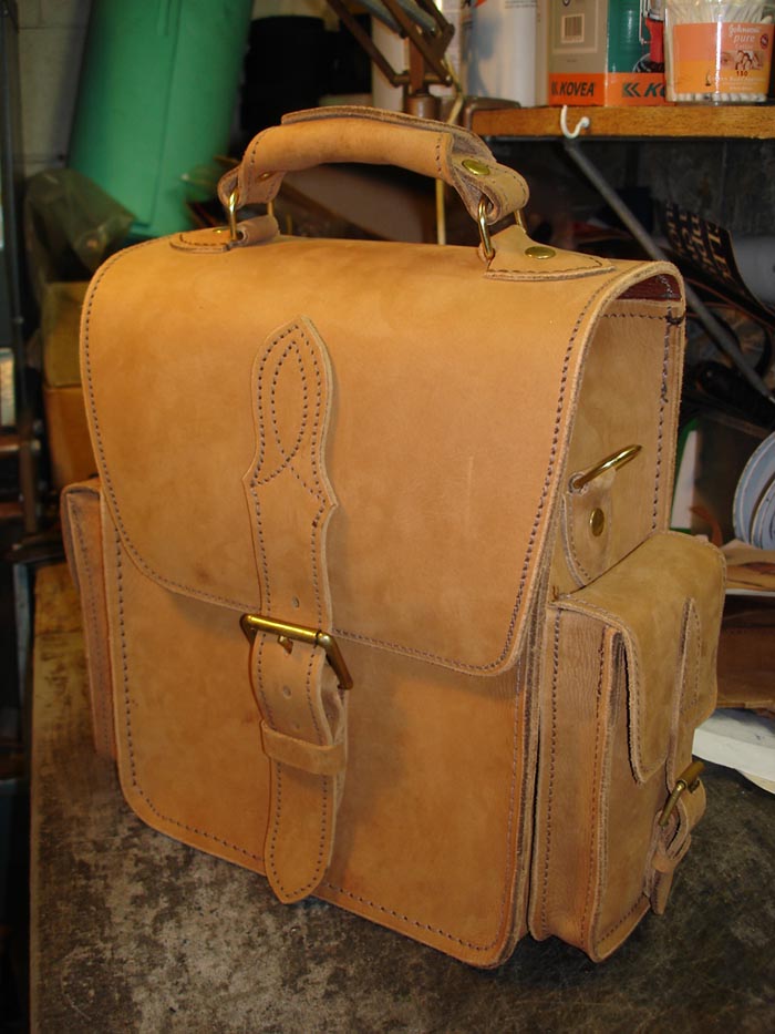

Hi there. This was my attempt to make a saddleback tote bag look a like. I changed a few things and used all brass hardware. lined the lid and installed a zipper inside as well. I also did a couple of smaller ones which are ok but need a little improvement. Overall quite happy with the result. Thanks for looking. Cheers -
