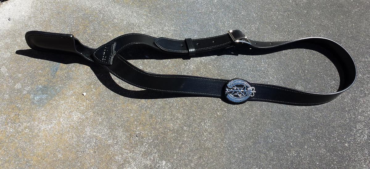

hi there odd Here is the flag holder that I make. Both the same just different colours. Cheers Trevor Way Down Under
