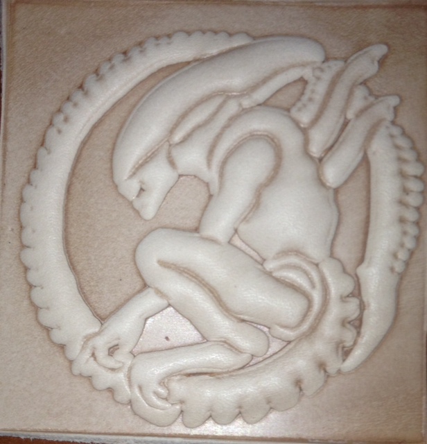

A special thanks to Grey Drakkon for his suggestion that I make the alien facehugger. I think it turned out good and I think it will look good embossed next to the alien xenomorph. Both are roughly 2.75" square. Engraved on delrin plastic as an embossing plate. Cheers! -Nick

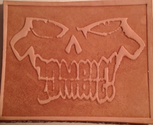

Zombie Wallet Back Plate
Studio-N replied to Studio-N's topic in Purses, Wallets, Belts and Miscellaneous Pocket Items
great. I hope to see them sometime. -Nick -

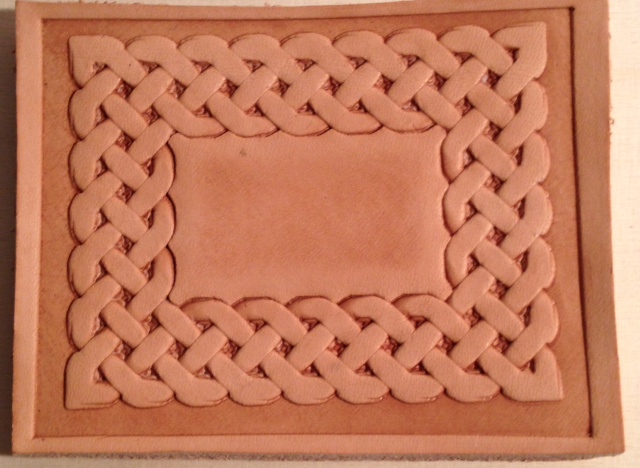

Celtic Weave Wallet Back Plate
Hello Michelle, These are directly cut with a CNC router into 1/2" thick delrin. These could probably be cast from these models, but it is just as easy to cut them individually now. Cheers! -
thank you. I test these with a 1 ton arbor press (which has a 1" square ram). I start in one corner, press them move over 1 inch. Rinse and repeat until it is done. If I want to do it all at once, I've got a 12 ton shop press that can do the job. I have found that if I put a piece of rubber or thick leather underneath the piece I'm going to press, it helps to push the leather up into the stamp for a good deep embossing, especially on thin (4/5 oz) leather like used on a wallet back. Cheers! -
