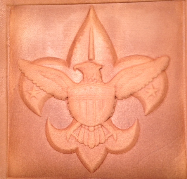

And One For The Boy Scouts
Studio-N replied to Studio-N's topic in Gun Holsters, Rifle Slings and Knife Sheathes
thank you. -

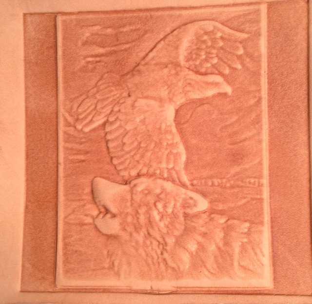

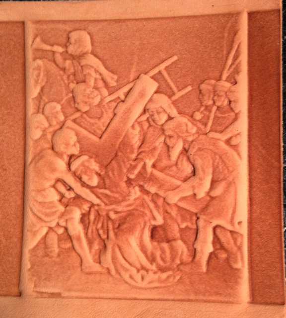

To see the others, I think you can just view my profile and then check my content. Some interesting points- some forms are actually silhuettes in the original woodworking models. Some are the results of the limitaion of the tools (including the leather). The facial features for instance are small in what is typically a 12 inch model. Once I reduce that to 3 inches, the eyes nose and mouth are but a blip although technically still there. I am using a 1/16" ball nose bit to do the carving, However those blips are thinner than 1/16" so as a result they don't get put in, or if they are in, the leather can't stretch enough to get up into that tiny recess. The end result is only the 'hint' of a face. Of course, an embossing stamp is just a tool and is often just a starting point. It takes a lot of the big work out of a project and details can still be put in manually. I have a customer who is using these and he still goes thu and bevels around the figures and adds in little detail. The end result is he has taken what I give him and greatly improves it for some very nice results. I'm trying to make some stamps that can stand on there own but there is alway the human touch that's needed. Cheers! -

This was done for a boy scouts customer. Again, remember that these are converted from some models for woodworking. So much fun, so little time in the day.

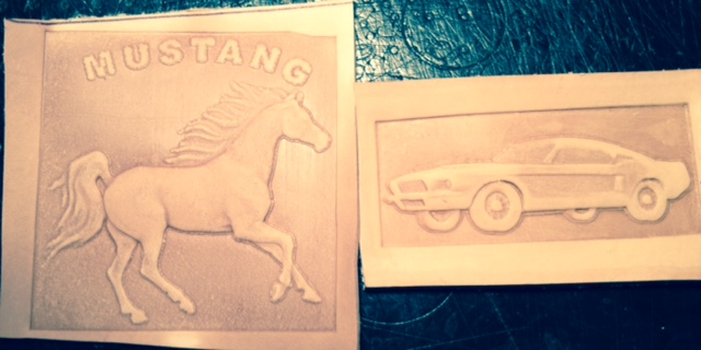

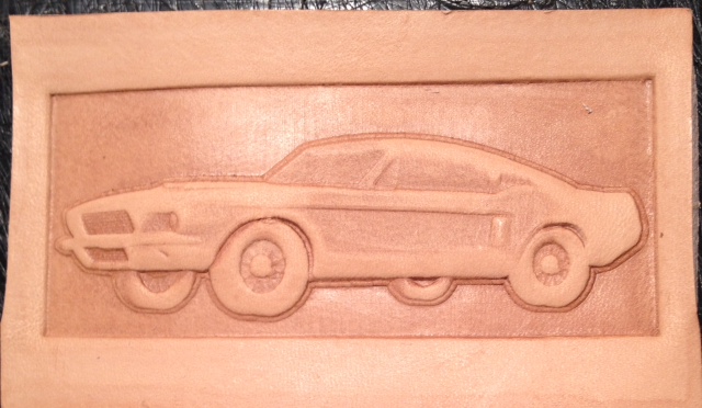

I'm surprised no one caught this on the last batch I put up. The photo on the right is the first one I put up. The problem is - it is inverted. Notice the eyes and nose are pushed in. The one on the left is the corrected model. much improved. I guess it is because it is such a recognizable figure I only took a cursory look at it and said 'yep, that's him'. cheers!
Mustang Wallet Back Plate
Studio-N replied to Studio-N's topic in Purses, Wallets, Belts and Miscellaneous Pocket Items
No denying it! -

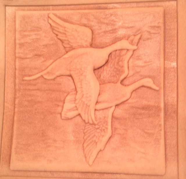

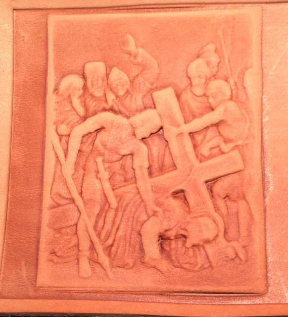

had a very busy week doing these for a customer. All are 3" high. Only showing the results. the plastic die is pretty unimpressive. Some of the tinyist details such as the faces of the bears or in the religious scene aren't there, because frankly at that size the detail is smaller than the width of bit so it can't get in there. Customer was ok with that, since it is something he can put in by hand or with the swivel knife. As before all are on delrin plastic. The axes were done on the laser, the rest on the CNC machine. None of these are exclusive stamps, so they are available if you need them. Cheers!
