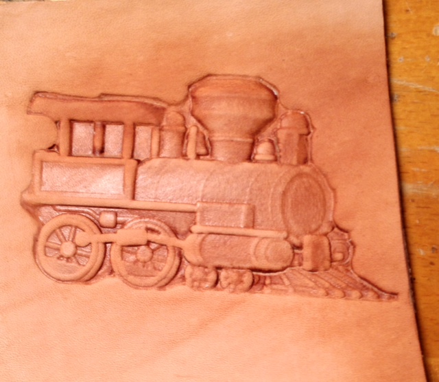

Here's a couple of new plates I made for a customer of mine. The long train is 8" long for a wallet back. The short train is 3". Once agian, they are made on delrin plastic and were done on the CNC machine. I sure did learn thing about cutting thru the double face tape I use to hold these down - the bit was gunked up big time when done. Cheers!

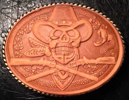

This is something different from my usual wallet back plates. This was cut to fit in the oval rope edge belt buckles like the evil empire sells. It would also fit on a larger oval where you lace the leather around an oval buckle back. I went the first route for the sample 'cause I've just been to busy to lace. As usual, the plate is cut into 1/2 thick delrin plastic so it should hold up pretty well. Cheers! -

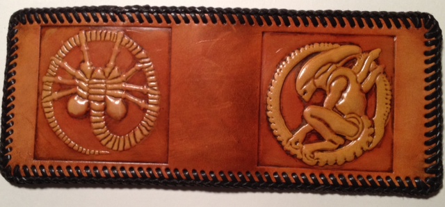

Hi Ray and thanks. I think it just an evolution. I still do mostly laser work. I just don't get to show those as lots of them are proprietary works for other clients. I'm enjoying the CNC since it is the 'new toy' and there is just so much new stuff to learn. And in this case I am pesonally enjoying the more realistic look it has and for me - the laser is the business, the CNC is still my personal hobby. These new idea are keeping me fresh. Pretty soon I'll be mixing the two and my head will explode until some new technology comes out (and in fact I have some new technolgy coming which is going to pretty cool). Many regards, Nick -
hello. Yes it is an embossing not a carving. Unable to edit the original post to that effect. -nick

thank you Bob. This is for show and tell at my CNC group next week. they've seen my models and plates, but I haven't shown a finished product that uses them. I think they'll like it. Nick -
