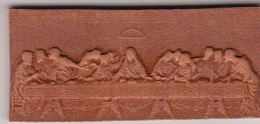

This was an attempt at the last supper. It is in silhouette and is 1.25" high by 2.75" long. Although it is in silhouette it is instantly recognizable. It should be ok on a wristband. Cheers!

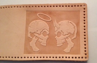

This was done in delrin. I've got my CNC machine on order so I know it will be useful on some of my applications, plus i'll be able to transition to some light metals as well. But I'll continue with the delrin on CNC since the material really only has to be harder than leather to work. Don't forget that it's also important to have the right software to do this. Here is another stamp that was successful. While I'm not showing the profile, there is a slight dome to the crown of the skull on which I have added an anarchy symbol that sits atop the dome. The software has to create at least a 16bit greyscale to get a good result. 8 bit greyscales end up not giving you enough shades to attach different power levels to, so it comes out more blocky than the 16 bit. I'm using ASPIRE which is for CNC routers and is expensive. For regular 2D stamps (text, silhouettes, flat figures) I'm still working with Corel Draw which you'll find does a fine job. As for the textured surface, it is a consequence of the greyscale. When you tune your machine, WHITE will be 0%. Which means only things at the surface level of the material. Every thing else is a shade of grey and gets hit with the laser at some power level other than zero. So the entire stamp face is one big pixelated surface (hence the texture). When you lay out a 2d stamp, it is 0 or 100%. so there are large areas that are untouched which form an even depth smooth impression. Once you do a couple it all comes together. I have seen a couple of things done with the 3D printer and I think it will work. I also think it will leave a textured surface because while they don't advertise it much, much of the stuff 3d printed still requires a little sanding. I have to say it's getting expensive for these new developments. It sometimes takes 3-4 iterations to get it the way I want it. But at the same time, I haven't had this much fun in years.
