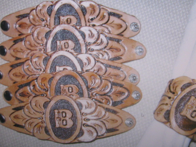

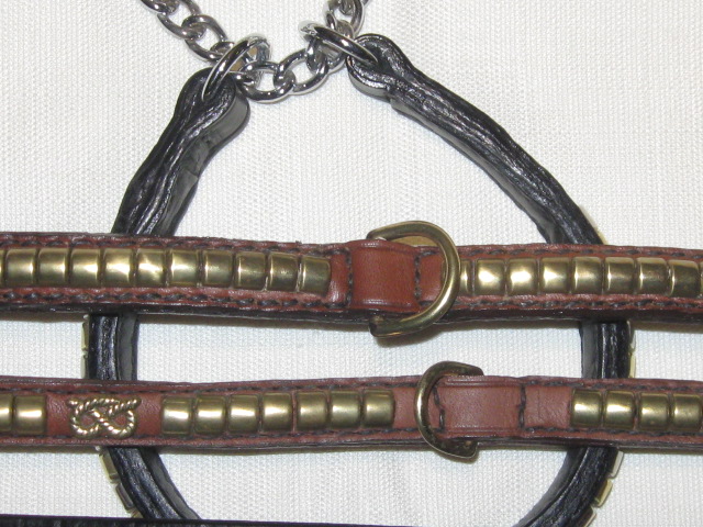

Here is a photo of the harness I just finished, & dog collars I make.

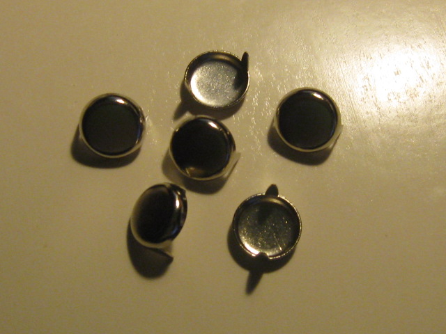

I use a lot of Metal spots. So when sewing the collars with the spots, what attachments will I need ? Can I use the CB3200 ?
