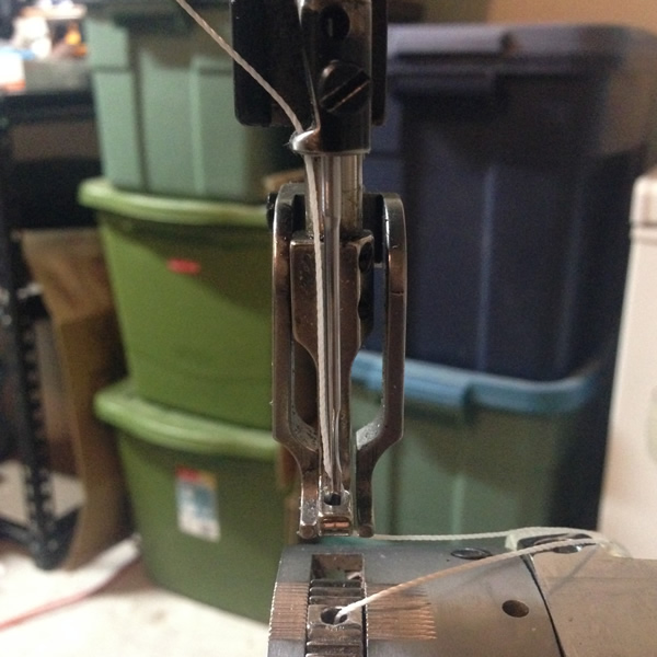

Wizcraft, I knew you'd have the answer. That said, I'm a bit more remedial... Can you tell me how to adjust those two variables? I'm lacking a manual to go along with my specific machine, so I'm just figuring things out as I go with a lot of help from you guys. I also noticed that pressor feet were not perfectly aligned. I'm not sure if this is an issue, so I took a picture (see below). Can they or should they be aligned better? Could this be the issue? It seems that with with every stitch the material shifts to the left a few millimeters. -
